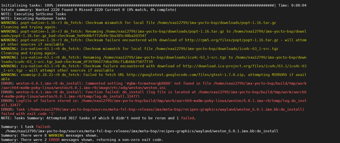

 6.Error fix
if you don’t change Weston, you should get the error message like
so try to change the Weston to the 5.0.0 step by step
$ git clone https://git.yoctoproject.org/git/meta-freescale -b zeus
$ rm -rf ../sources/meta-fsl-bsp-release/imx/meta-bsp/recipes-graphics/wayland
$ cp -r meta-freescale/recipes-graphics/wayland ../sources/meta-fsl-bsp-release/imx/meta-bsp/recipes-graphics
$ bitbake -c cleansstate weston
$ bitbake  weston
$ bitbake  meta-ivi-image
