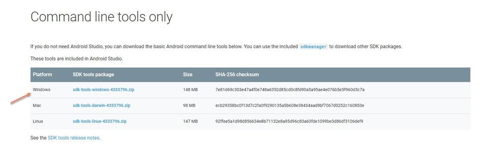

To use the Android kernel or give root access to your Android device, it is needed to have some tools from the Android SDK like ADB or fastboot. To download those tools just go to below web-page:
https://developer.android.com/studio#downloads
Go to the “command line tools only” part and download the sdk-tools-windows-4333796.zip package.

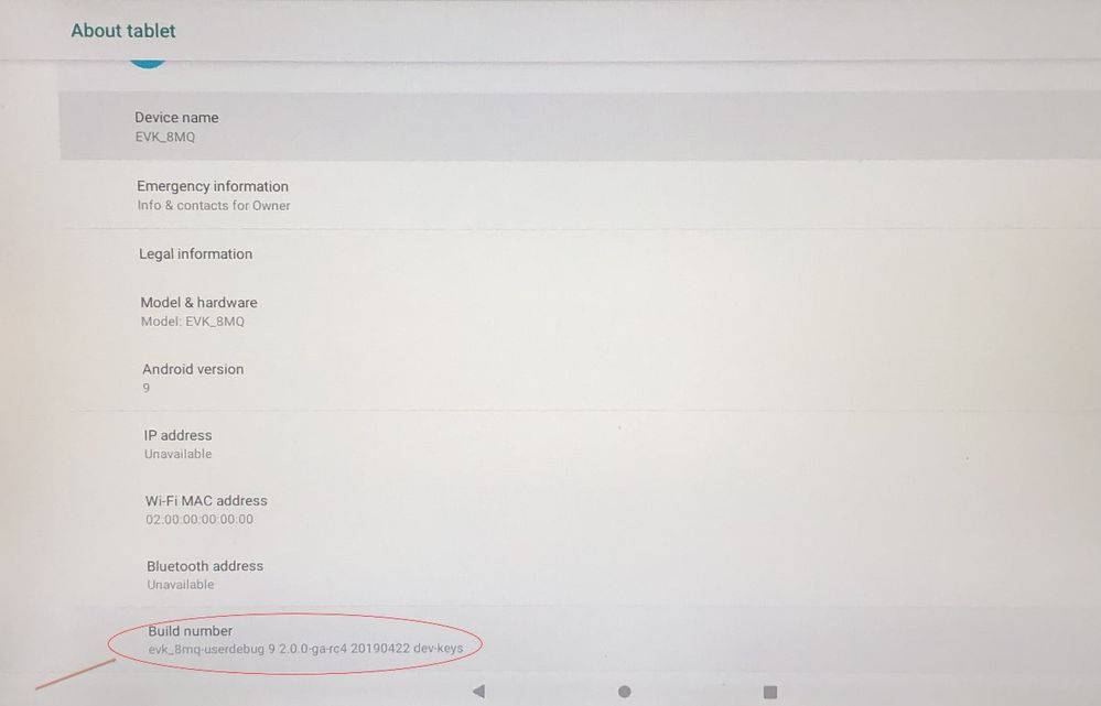

On the Android GUI go to Settings -> systems -> About Phone
At the bottom, you should see the build number of your Android device. Tap it multiple times until appears on the screen that you are a developer now.

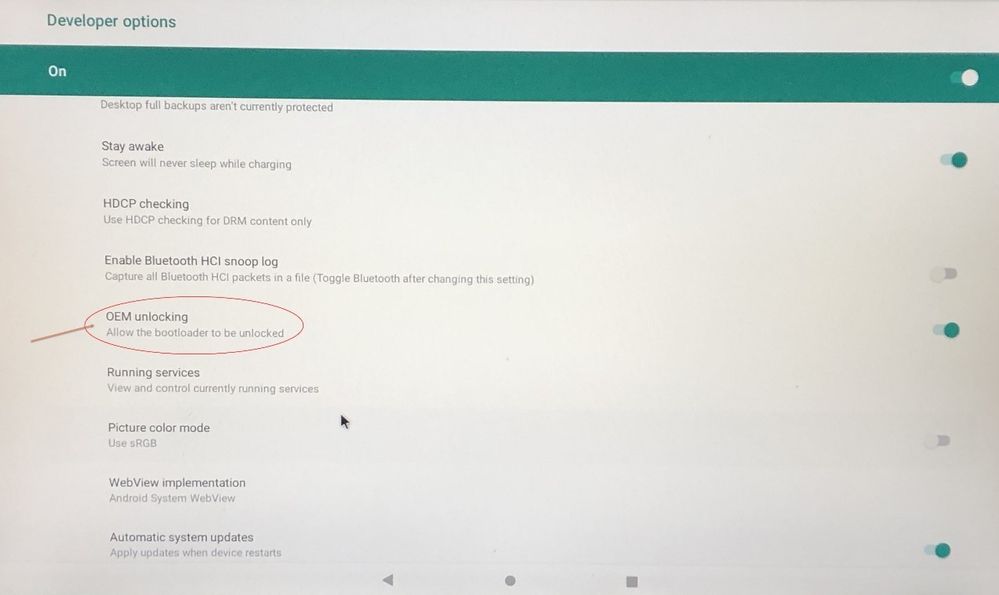

Go to the developer options and search for the OEM unlock option. You need to activate that option.

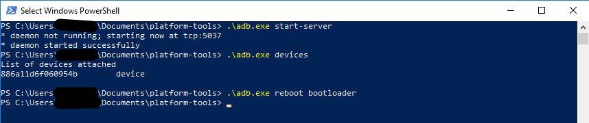

Then you will use the ADB tool (Adroid Debug Bridge). To use it you need to run adb.exe in your power-shell terminal. To run an executable in the Windows terminal is just with ".\".
Connect the serial download cable to the host computer (the Type C for the i.MX8M and i.MX8MM. The OTG for the i.M6 SabreSD boards).
Open the adb server.
.\adb.exe start-server‍
See your connected devices.
.\adb.exe devices‍
You should see your device and the serial number that is assigned to the device.
Then, enter into Bootloader mode.
.\adb.exe reboot bootloader‍

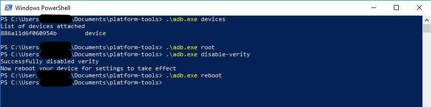

Then root the board
.\adb.exe root
After rooting the board, disable the dm-verity option
.\adb.exe disable-verity‍
After disabling the verity option, it will request you to reboot your board. Just reboot your board.
.\adb.exe reboot
With that, you should have successfully disabled the verity option on your board.

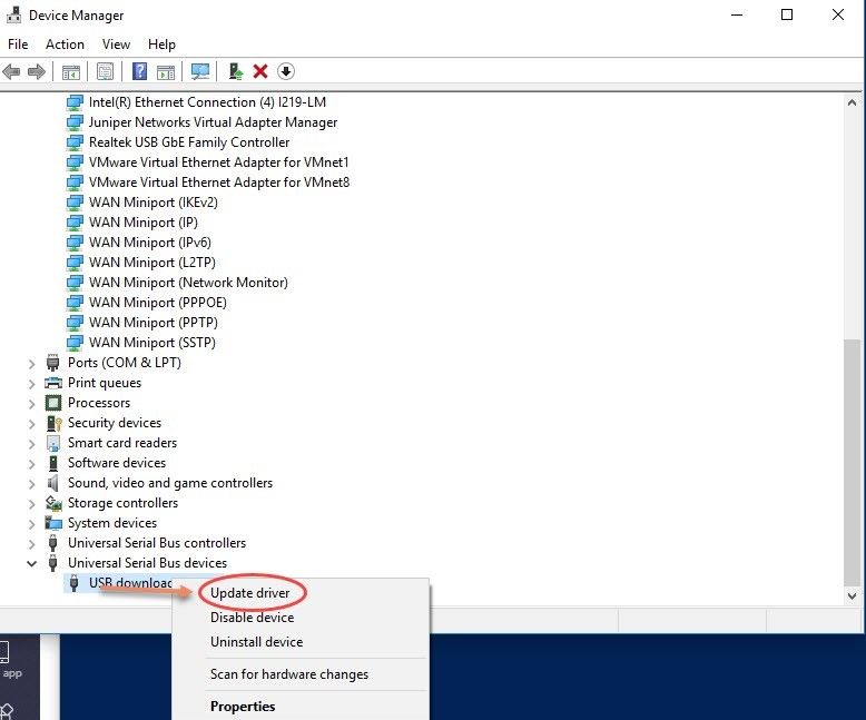

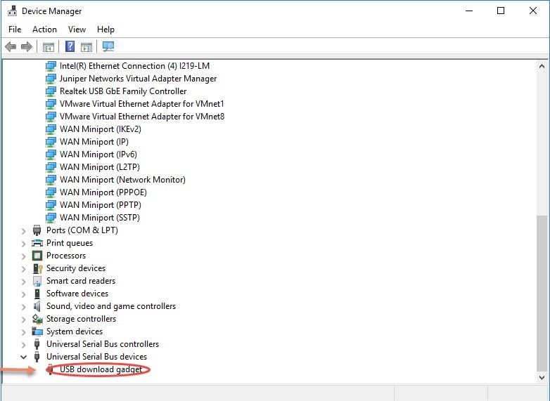

Appendix A Update the USB driver (For Windows only)
If your computer does not recognize once you are inside the bootloader mode. What you need to do is update the USB driver. To update the driver, follow the below steps.
First, open your device manager and locate the Universal Serial Bus devices -> USB download gadget.
Then press the right-click and select the Update driver option.

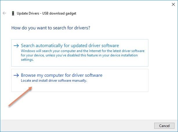

Select the “Browse my computer for driver software” option.

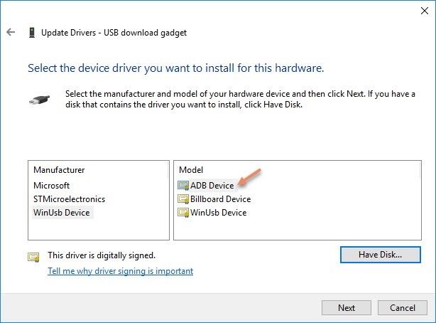

Select the “Let me pick from a list of available drivers on my computer” option.
Select the ADB Device Model.
And accept to install the driver. After that, your computer should recognize the board being into Bootloader mode.

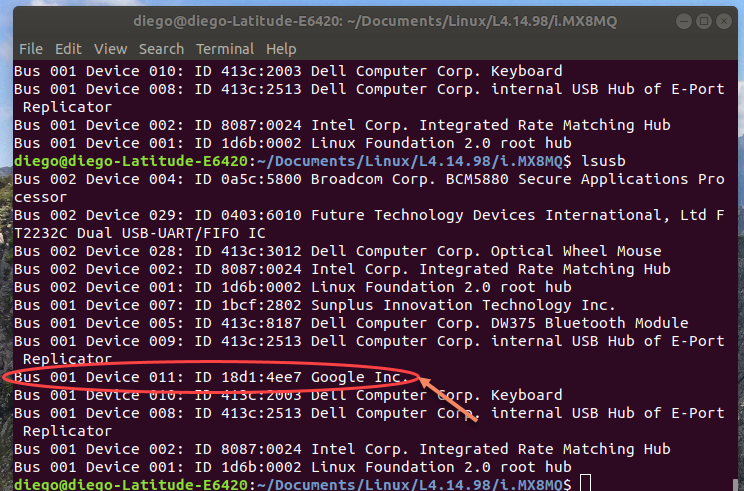

Appendix B connects your Android device to a Linux computer through ADB.
You could face some adb problems if you want to connect your Android device to a Linux computer. If you want to use adb, the Android image does not allow you due to a permission problem. To make it work, you need to create a new rule for a plug device.
To make the new rule, create a document inside the /etc/udev/rules.d named 51-android.rules. Inside the document write the following:
SUBSYSTEM=="usb", ATTR{idVendor}=="18d1", ATTR{idProduct}=="d002", MODE="0660",
 GROUP="plugdev", SYMLINK+="android%n"‍‍
Where the ATTR{idVendor} and ATTR{idProduct} is the USB id for the board. To know that information. Write lsusb and your Android device is the one named Google Inc.
Then reboot your computer. With this new rule, ADB should work as usual.
