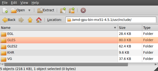

After that you have to copy gpu's driver headers files in the include folder of the project. You will find these header in /opt/freescale/pkgs/amd-gpu-bin-mx51-x.x.x.tar.gz archive:
  • extract all the include folders/files in the include folder of the project.

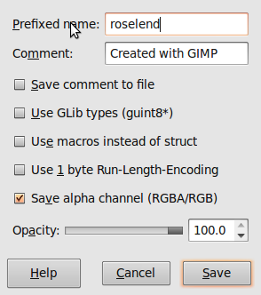

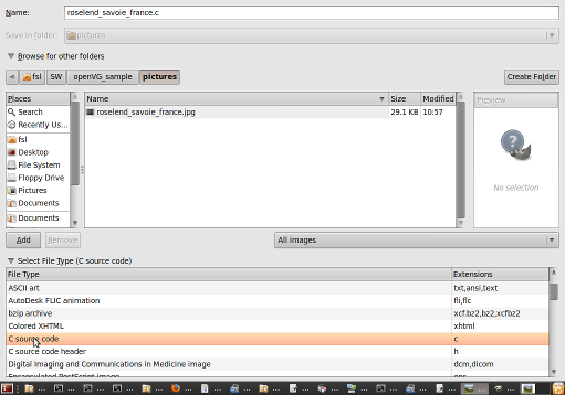

A simple way to modify the image, is to use The Gimp. When you want to save your image, choose "C source code format":
Then choose the prefix name (here "roselend"):
Click on "Save". The "C" file of your image is generated:
