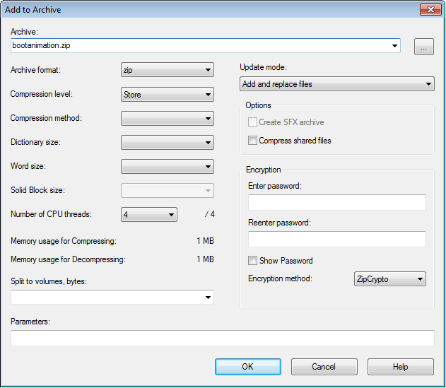

- 7-Zip. This is a free compression tool and has the necessary settings for preparing the boot animation file. It is important that the boot animation file is in Zip format with no compression, otherwise the file won’t be read and the animation will not be shown. Zip tools integrated on some Operating Systems may not always allow for these configurations.

The animations used by Android when booting are actually a series of images in either jpg or png format in a zip file with no compression (storage mode) and a text file (desc.txt) with the specified resolution, framerate and loops to be played by the animation.
Each folder containing a part of the animation must contain the images numbered from 000 onwards.  This file is always called bootanimation.zip An example of a boot animarion can be found attached to this document.

It is important that no other files are included on the bootanimation.zip file. This includes the thumbnails created automatically by Windows. Please delete them from your fule before loading it to the board.
