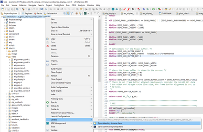

  1. Unzip the MCUXpresso SDK if not done so already
  2. Open an eIQ project
  3. Find the directory the eIQ project is located in by right clicking on the project name and select Utilities->Open directory browser here

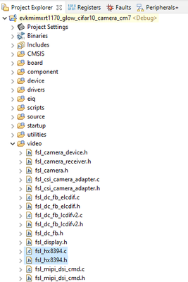

  1. Copy both the fsl_hx8394.c and fsl_hx8394.h files found in \SDK_2_11_1_MIMXRT1170-EVK\components\video\display\hx8394\ into your eIQ project. You can place them in the video folder which would typically be located at C:\Users\username\Documents\MCUXpressoIDE_11.5.0_7232\workspace\eiq_demo_name\video
  1. Overwrite the eiq_display_conf.c and eiq_display_conf.h files in the eIQ project with the updated versions attached to this post. Typically these files would be located at C:\Users\username\Documents\MCUXpressoIDE_11.5.0_7232\workspace\eiq_demo_name\source\video
6. Compile the project as normal and the eIQ demo will now work with the new LCD panel for RT1160/RT1170.
