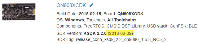

The QN9080 SDK was updated after Feb 8th to correct this issue in the power profiling example. Please make sure in the MCUXpresso SDK Dashboard that you are working with the latest SDK version:
A quick way to know if you have the updated SDK, is to look for the following code in red present in board.c for the power_profiling project:
uint8_t BOARD_GetBatteryLevel(void)
    uint32_t adcConvResult = 0;
    float fresult;
    if (SYSCON_PMU_CTRL1_ADC_DIS_SHIFT & SYSCON->PMU_CTRL1) //ADC power disabled?
        POWER_EnableADC(true);
With this SDK, you should be able to reach the power consumption values reported by the AN01786 app note.
Additionally, you can implement the same changes done in board.c of the power profiling demo to the temperature sensor demo to further improve the power consumption. The improvement will not be as much as with the power profiling demo, but still a small improvement.
