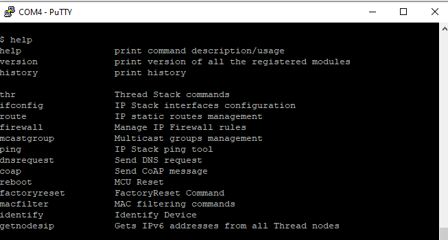

As you noted, in our SDK are 2 possibilities for serial communication:
- shell
- THCI.
Shell is let say human-readable format. All the commands are listed using the help command
THCI has been designed for communication with a host processor. The format of the command is containing an opgroup, messageType, CRC... This is what I specified in this comment: https://community.nxp.com/thread/464273#comment-962988

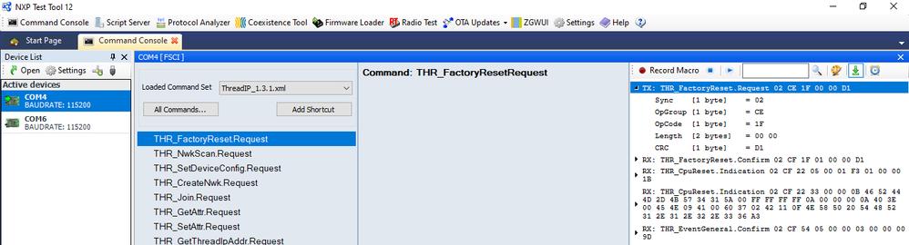

All of the THCI commands can be sent from TestTool (https://www.nxp.com/webapp/sps/download/license.jsp?colCode=TESTTOOL_SETUP&appType=file1&location=nu...).
In this case, the TestTool is used to simulate an application processor.
For example, the THCI Factory Reset Command:
As you can see, the format of the command is: 0x02, 0xCE, 0x1F, 0x00, 0x00, 0xD1
where you should map this command to:
STX = 0x02
Opcode Group = 0xCE - used to identify a Thread IP Stack command
Message Type = 0x1F - used to identify the gTHCI_ThrFactoryReset_c command
Lenght = 0x0000;
No Payload
CRC = 0xD1;
Considering the implementation from this comment:https://community.nxp.com/thread/464273#comment-963478
you should use something like:
uint8_t APP_SendResetToFactoryDefault(void)
        clientPacketHdrr_t header = {
                                       .startMarker = 0x02,
                                        .opGroup = 0xCE,
                                        .opCode = 0x1f,
                                        .len = {0x00, 0x00}
         clientPacket_t resetToFactoryDefaultCmd;
         /* copy the header */
         memcpy(&resetToFactoryDefaultCmd.structured.header, &header, sizeof(header));
         /* copy the payload if required */
         //memcpy(&resetToFactoryDefaultCmd.structured.payload, &payload, payloadLen);
          /* call the function to send data via the serial  - this function will add the CRC and use the right format for the command*/
         THCI_TransmitFormatedPacket(&resetToFactoryDefaultCmd);
Let me know if you need more details,
Ovidiu

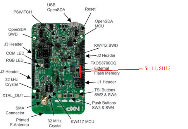

I'm not aware for an existing example of using a host uC to control kw41, other than linux examples, but this could be easily build it.
The fist step is to set the UART FRDM header pins:
-  in function BOARD_InitLPUART you should enable the following:
     PORT_SetPinMux(PORTC, PIN17_IDX, kPORT_MuxAlt4);            /* PORTC17 is configured as UART0_RX */
     PORT_SetPinMux(PORTC, PIN18_IDX, kPORT_MuxAlt4);            /* PORTC18 is configured as UART0_TX */
     SIM->SOPT5 = ((SIM->SOPT5 &
             (~(SIM_SOPT5_LPUART0RXSRC_MASK)))                        /* Mask bits to zero which are setting */
              | SIM_SOPT5_LPUART0RXSRC(SOPT5_LPUART0RXSRC_LPUART_RX) /* LPUART0 Receive Data Source                Select: LPUART_RX pin */
  - this is used to forward the UART messages from USB to FRDM - UART header (J1 header - pins 6 - UART0_TX, 7 - UART0_RX). Please consider that based on the board Revision, you will need to solder SH12 and SH11 connections.
The next step is to decide what do you want to use: Shell or THCI and implement the same on the Host uC.

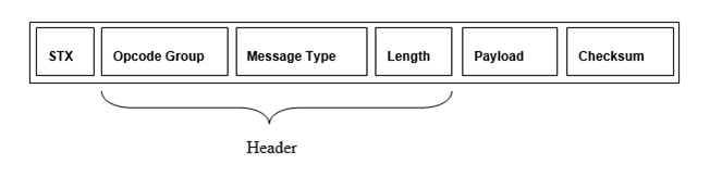

For THCI you will need to consider the data transfer format, as below:
where the STX  is the synchronization byte, and by default is set to 0x02. The possible values for Opcode and Message type are detailed in the following document: Kinetis Thread Host Control Interface Reference Manual.
Please consider that the delivered sdk items contains also a C implementation for the THCI protocol, that could help you on the host app implementation. This is usually located in sdk at the following location:
