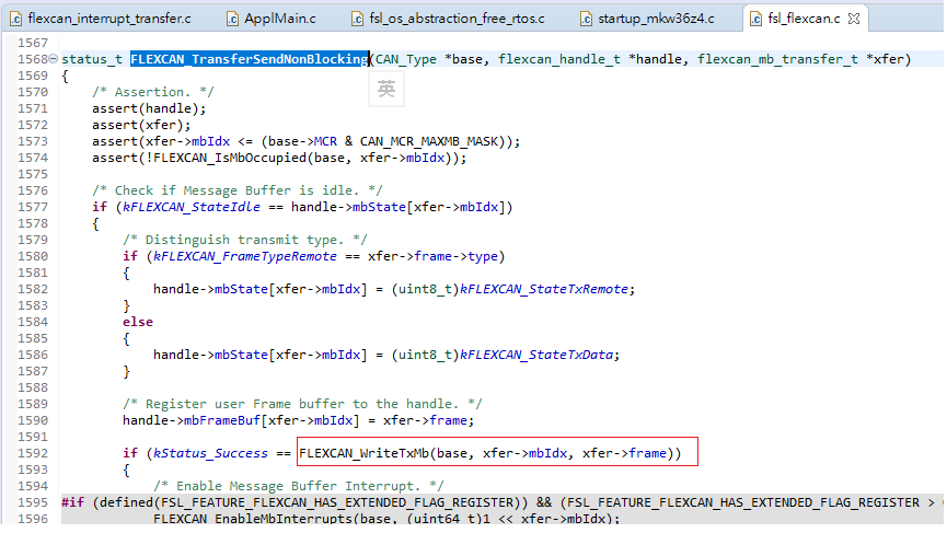

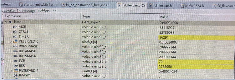

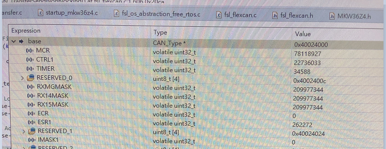

      I have tried adding CAN_init() to (frdmkw36_wireless_examples_bluetooth_w_uart_freertos) according to the instructions in the Application Note, but it seems that CAN-BUS still does not work. In order to confirm whether the CAN-Driver can run in the FreeRtos project, I tried to dump the register value after executing "FLEXCAN_WriteTxMb()" and compare it with (frdmkw36_driver_examples_flexcan_interrupt_transfer) , As shown in the figure below, we can see that the register value of the yellow item is wrong . Can anyone provide me with some suggestions, Many thanks.
Source Code :
Wrong memory content :
Correct memory content :
