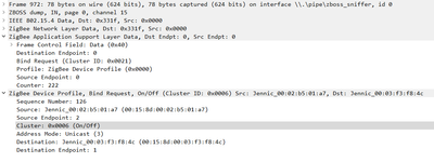

At the same time I am still confused with NXP Zigbee API. Here is a dump of Bind Request the coordinator is sending to my device
In this request you can clearly see Cluster ID field. And this ID should be eventually passed to ZPS_eAplZdoBind(). Unfortunately Zigbee Stack does not deliver this cluster ID to the ZDO handler. There is simply no such a field in ZPS_tsAfZdoBindEvent structure

Let me rephrase. I am talking about ID of the cluster to bind. E.g. My device may implement various clusters - On/Off, thermometer, OTA, but I would like to bind specifically On/Off one.

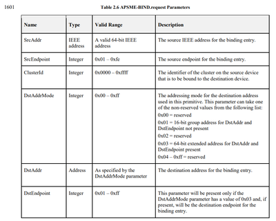

As per Zigbee specification Bind request message looks like this
As you clearly see, there is ClusterID field. In the sniffer screenshot you can see this field as well (set to 0x0006 On/Off). From what I see this low level zigbee message is converted to ZPS_tsAfZdoBindEvent structure, that has everything, except for Cluster ID.
I even disassembled the stack code, and looks like parsing low level Bind request message and converting it to ZPS_tsAfZdoBindEvent happens in bAplZdoBindUnbindServerProcessApdu(). Unfortunately this function comes without sources, so I cannot fix it myself.
So the question is: would it be possible to add ClusterID field to ZPS_tsAfZdoBindEvent? You have all needed information for this already.
