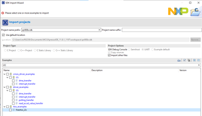

I'm trying to use the I2C communication module in QN9080 with MCUXpresso.
Are there any good documents providing the example codes?

Hi, @DeeY
For I2C communication, please refer to our SDK:
SDK_2_2_9_QN908XCDK\docs\MCUXpresso SDK API Reference Manual_QN908x\
There are some html files you can open and refer to.
Compile our SDK and download it form this link:
https://mcuxpresso.nxp.com/en/welcome
Only input QN9080 after click "Select Development Board", then compile and download it.
And also, after install the SDK, you can import below I2C examples to check  source code.
