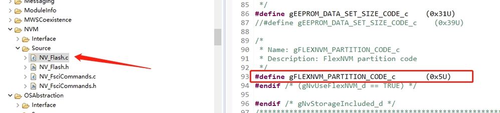

I want to use eeprom in KW36 BLE demo. In frdmkw36_wireless_examples_bluetooth_hrs_freertos, I set gAppUseNvm_d and gNvUseFlexNVM_d to 1. In __NvModuleInit(), it configures eeprom and reset. However, after it reset, in hardware_init(), it calls NV_ReadHWParameters(&gHardwareParameters), and then it run into HardFault_Handler()! How to use eeprom in BLE demo?
in __NvModuleInit(), before I call FLASH_ProgramPartition(...),the data at 0x7f800:
after I call  FLASH_ProgramPartition(...):

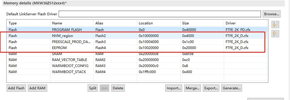

jictannu
Thanks for youe response!
I set the flash as below:
 and I set the backup size to 128KB:
It looks like work.

Xiang_Li
Glad it works!
Just want to point out small things in your picture.
- FREESCALE_PROD_DATA only needs 2KB I think, but you assigned a size of 7KB (0x1C00). Seemingly unnecessary.
- After 128KB reserved for EEPROM, there should be 128KB (0x20000) left in D-Flash. But now you are only use 0x4000 + 0x1C00 of those. About ~100KB in the device not allocated and not seen from the current memory map.
