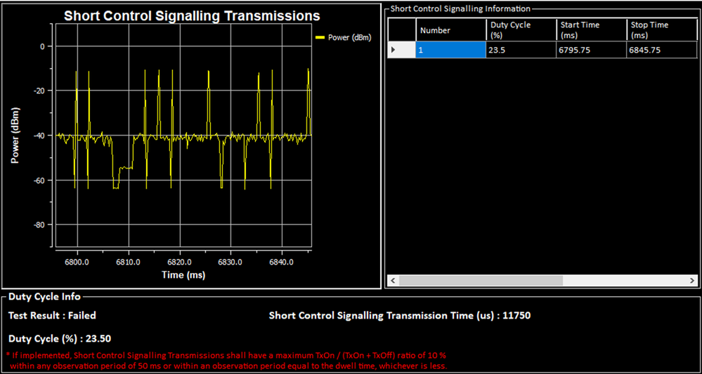

1) The payload duty cycle we are getting is less than 30% and we are not able to adjust the duty cycle. Actual results = 7.35%.
Expected result > 33% and it should be adjustable up to 100% to perform the adaptivity test. (See attached image-1)
2) Module is not stopping the signal transmission within maximum channel occupancy time during the interference signal insertion in the same channel.
Expected: The module has an adaptivity function and it should stop signal transmission when an interference signal is added to the channel. (See attached image-2.1, image-2.2)
3)  Short signaling transmission time is ~12 msec.
Expected: It should be less than 5mSec.

riteshpatel
1) Lab response "FAIL DATA is at 2412 b mode, the package can't make it 30%, so we stop here."
The lab has mentioned in the report that the duty cycle of the payload must be >30%. I believe, payload means the packet transmitted.
3) FAIL DATA is at 2412 b mode.
- The Short control signalling time should be <5mSec.
- Attached image showing in our case we are getting 11.75mSec
