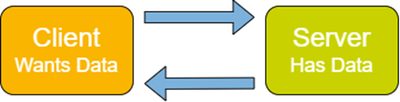

GATT defines the way that profile and user data are exchanged between devices over a BLE connection. GATT deals with actual data transfer procedures and formats. All standard BLE profiles are based on GATT and must comply with it to operate correctly, making it a key section of the BLE specification since every single item of data relevant to applications and users must be formatted, packed and sent according to the rules.
There are two GATT roles that define the devices exchanging data:
  • GATT Server
This device contains a GATT Database and stores the data transported over the Attribute Protocol (ATT). The Server accepts ATT requests, commands and confirmations sent by the Client; and it can be configured to send data on its own through notifications and indications.
  • GATT Client
This is the “active” device that accesses data on the remote GATT Server via read, write, notify, or indicate operations. Notify and indicate operations are enabled by the client but initiated by the server, providing a way to push data to the client. Notifications are unacknowledged, while indications are acknowledged. Notifications are therefore faster, but less reliable.

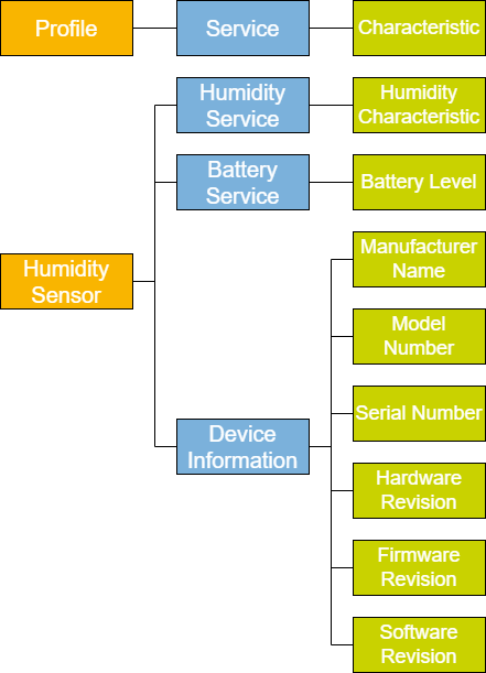

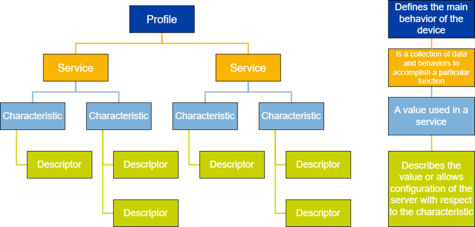

GATT Database establishes a hierarchy to organize attributes and is a collection of Services and Characteristics exposing meaningful data. Profiles are high level definitions that define how Services can be used to enable an application; Services are collections of Characteristics. Descriptors define attributes that describe a characteristic value.
Server (Sensor)
The Temperature Sensor project will be used as base to create our Humidity Custom Profile Server (Sensor).
  • BLE SIG profiles
Some Profiles or Services are already defined in the specification, and we can verify this in the Bluetooth SIG profiles document. Also, we need to check in the ble_sig_defines.h files (${workspace_loc:/${ProjName}/bluetooth/host/interface}) if this is already declared in the code.
In this case, the Service is not declared, but the Characteristic of the humidity is declared in the specification. Then, we need to check if the Characteristic is already included in ble_sig_defines.h. Since the characteristic is not included, we define it as shown:

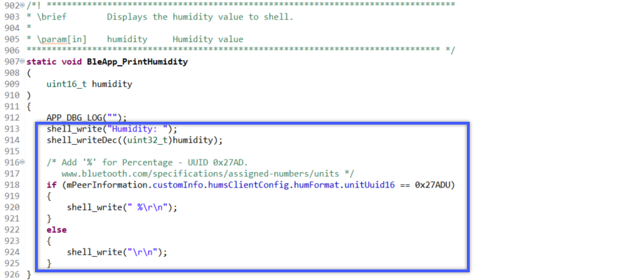

  • Units
All the Services and Characteristics are declared in gatt_db.h. Descriptor are declared after the Characteristic Value declaration, but before the next Characteristic declaration. In this case the permission is the CharPresFormatDescriptor that have specific description by the standard.
The Units for Humidity Characteristic is Percentage, defined in the Bluetooth SIG profiles document as 0x27AD.

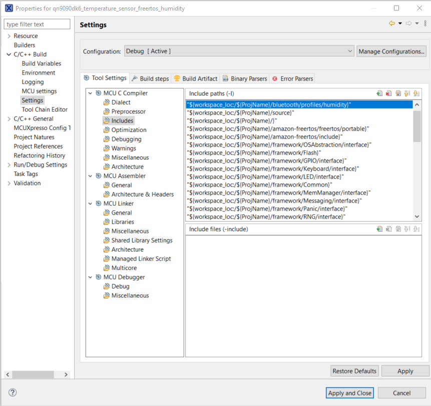

Create a folder named “humidity” in path ${workspace_loc:/${ProjName}/bluetooth/profiles}. In the same path you can find the “temperature” folder; copy the temperature_service.c file and paste it inside the “humidity” folder with another name (humidity_service.c). After this, go back to the “temperature” folder and copy the temperature_interface.h file; paste it inside the “humidity” folder and rename it (humidity_interface.h).
You will need to include the path of the created folder. Go to Project properties > C/C++ Build > Settings > Tool Settings > MCU C Compiler > Includes:

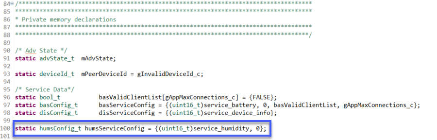

  • Declare humidity service
There are some modifications that have to be done in order to use the new Humidity Profile in the Sensor example. First, we need to declare the Humidity Service:
static humsConfig_t humsServiceConfig = {(uint16_t)service_humidity, 0};

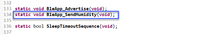

  • Rename BleApp_SendTemperature -> BleApp_SendHumidity
static void BleApp_SendHumidity(void);

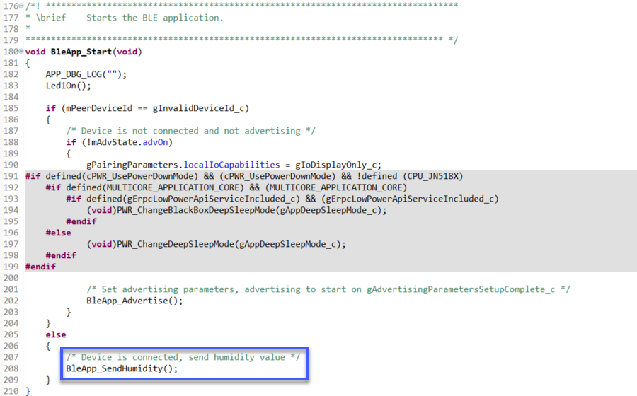

  • Modify BleApp_Start
/* Device is connected, send humidity value */
       BleApp_SendHumidity();

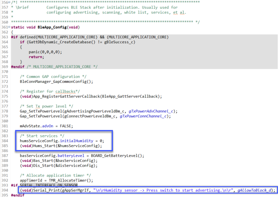

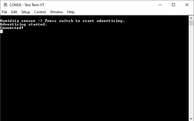

  • Ble_AppConfig
Start Humidity Service and modify the Serial_Print line.
/* Start services */
humsServiceConfig.initialHumidity = 0;
(void)Hums_Start(&humsServiceConfig);
(void)Serial_Print(gAppSerMgrIf, "\n\rHumidity sensor -> Press switch to start advertising.\n\r", gAllowToBlock_d);

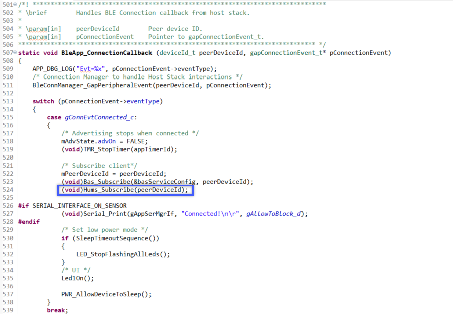

  • BleApp_ConnectionCallback events
- Event: gConnEvtConnected_c
(void)Hums_Subscribe(peerDeviceId);
- Event: gConnEvtDisconnected_c
(void)Hums_Unsubscribe();

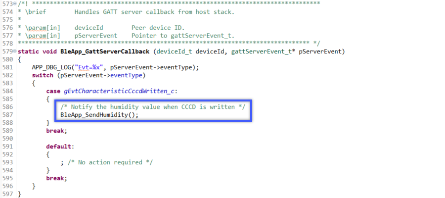

  • Notify value in BleApp_GattServerCallback function
/* Notify the humidity value when CCCD is written */

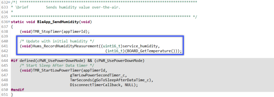

  • Add the Hums_RecordHumidityMeasurement function and modify the initial value update in BleApp_SendHumidity function
/* Update with initial humidity */
(void)Hums_RecordHumidityMeasurement((uint16_t)service_humidity,
                                           (int16_t)(BOARD_GetTemperature()));
Note: in this example, the Record Humidity uses the BOARD_GetTemperature to allow the developer to use the example without any external sensor and to be able to see a change in the collector, but in this section, there should be a GetHumidity function.

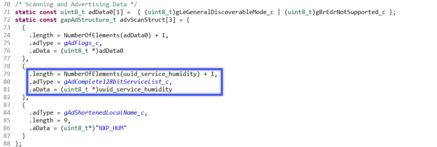

  • Modify Scanning and Advertising Data
    .length = NumberOfElements(uuid_service_humidity) + 1,
    .adType = gAdComplete128bitServiceList_c,
    .aData = (uint8_t *)uuid_service_humidity
  • *Optional* Modify name
    .adType = gAdShortenedLocalName_c,
    .length = 9,
    .aData = (uint8_t*)"NXP_HUM"

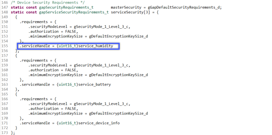

  • Modify Service Security Requirements
    .requirements = {
        .securityModeLevel = gSecurityMode_1_Level_3_c,
        .authorization = FALSE,
        .minimumEncryptionKeySize = gDefaultEncryptionKeySize_d
    .serviceHandle = (uint16_t)service_humidity

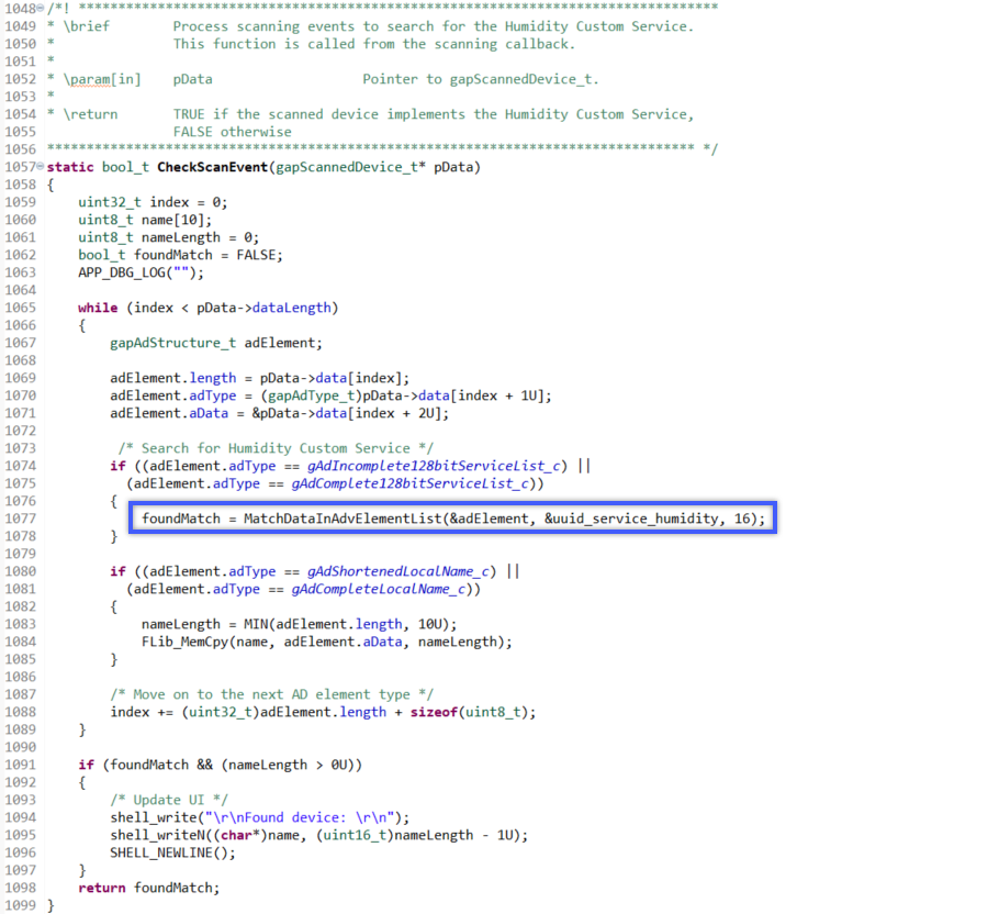

We will use the Temperature Collector project as base to create our Humidity Custom Profile Client (Collector).
  • BLE SIG profiles
As mentioned in the Server section, we need to verify if the Profile or Service is already defined in the specification. For this, we can take a look at the Bluetooth SIG profiles document and check in the ble_sig_defines.h file (${workspace_loc:/${ProjName}/bluetooth/host/interface}) if this is already declared in the code. In our case, the Service is not declared, but the Characteristic of the Humidity is declared in the specification. Then, we need to check if the Characteristic is already included in ble_sig_defines.h. Since the Characteristic is not included, we need to define it as shown:
/*! Humidity Characteristic UUID */
#define gBleSig_Humidity_d                    0x2A6FU
  • GATT Database
The Humidity Collector is going to have the GATT client; this is the device that will receive all new information from the GATT Server.

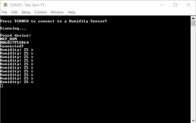

The demo provided in this article works in the same way as the Temperature Collector. When the Collector enables the notifications from the Sensor, received notifications will be printed in the seral terminal.
In order to create the demo, we need to define or develop a Service that must be the same as in the GATT Server, this is declared in the gatt_uuid128.h file. If the new Service is no the same, Client and Server will not be able to communicate each other. All macros, functions or structures in the SDK have a common template which helps the application to act accordingly. Hence, we need to define this service in the gatt_uui128.h as shown next:
/* Humidity */
UUID128(uuid_service_humidity, 0xfe, 0x34, 0x9b, 0x5f, 0x80, 0x00, 0x00, 0x80, 0x00, 0x10, 0x00, 0x02, 0x00, 0xfa, 0x10, 0x10)

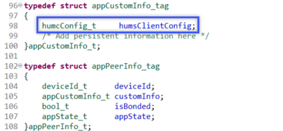

  • Modify the Custom Info of the Peer device
humcConfig_t     humsClientConfig;

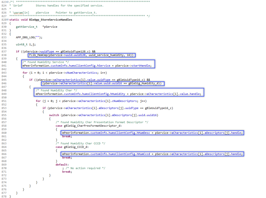

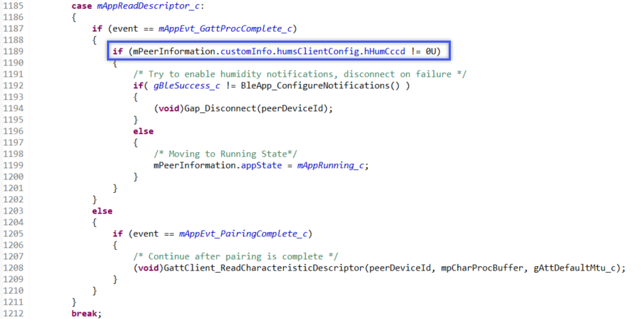

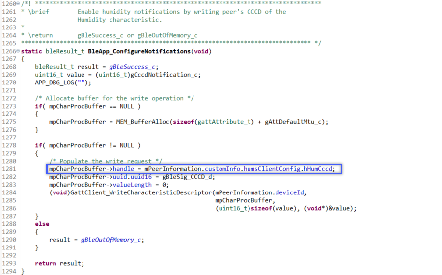

  • Modify BleApp_StoreServiceHandles function
static void BleApp_StoreServiceHandles
    APP_DBG_LOG("");
    uint8_t i,j;
    if ((pService->uuidType == gBleUuidType128_c) &&
             FLib_MemCmp(pService->uuid.uuid128, uuid_service_humidity, 16))
        /* Found Humidity Service */
       mPeerInformation.customInfo.humsClientConfig.hService = pService->startHandle;
        for (i = 0; i < pService->cNumCharacteristics; i++)
            if ((pService->aCharacteristics[i].value.uuidType == gBleUuidType16_c) &&
                    (pService->aCharacteristics[i].value.uuid.uuid16 == gBleSig_Humidity_d))
                /* Found Humidity Char */
            mPeerInformation.customInfo.humsClientConfig.hHumidity = pService->aCharacteristics[i].value.handle;
                for (j = 0; j < pService->aCharacteristics[i].cNumDescriptors; j++)
                    if (pService->aCharacteristics[i].aDescriptors[j].uuidType == gBleUuidType16_c)
                        switch (pService->aCharacteristics[i].aDescriptors[j].uuid.uuid16)
                            /* Found Humidity Char Presentation Format Descriptor */
                            case gBleSig_CharPresFormatDescriptor_d:
                                mPeerInformation.customInfo.humsClientConfig.hHumDesc = pService->aCharacteristics[i].aDescriptors[j].handle;
                                break;
                            /* Found Humidity Char CCCD */
                            case gBleSig_CCCD_d:
                                mPeerInformation.customInfo.humsClientConfig.hHumCccd = pService->aCharacteristics[i].aDescriptors[j].handle;
                                break;
                            default:
                                ; /* No action required */
                                break;

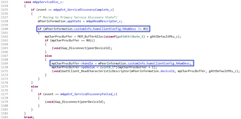

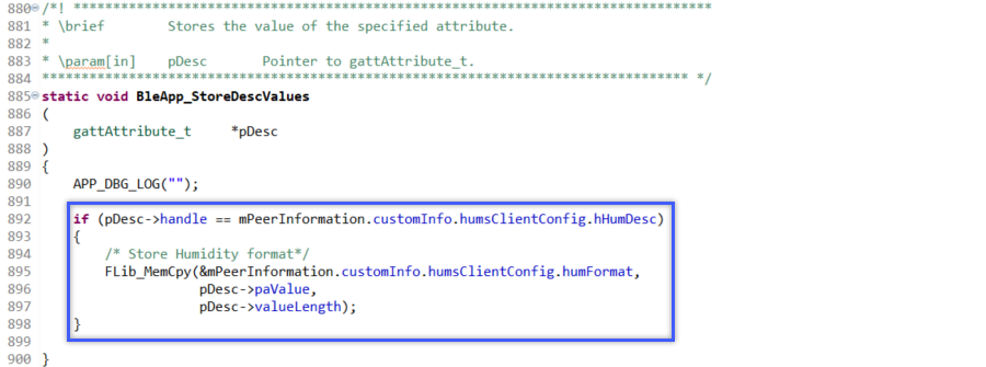

  • Modify BleApp_StoreDescValues function
if (pDesc->handle == mPeerInformation.customInfo.humsClientConfig.hHumDesc)
       /* Store Humidity format*/
       FLib_MemCpy(&mPeerInformation.customInfo.humsClientConfig.humFormat,
                    pDesc->paValue,
                    pDesc->valueLength);
  • Implement BleApp_PrintHumidity function
static void BleApp_PrintHumidity
    uint16_t humidity
    APP_DBG_LOG("");
    shell_write("Humidity: ");
    shell_writeDec((uint32_t)humidity);
    /* Add '%' for Percentage - UUID 0x27AD.
       www.bluetooth.com/specifications/assigned-numbers/units */
    if (mPeerInformation.customInfo.humsClientConfig.humFormat.unitUuid16 == 0x27ADU)
        shell_write(" %\r\n");
    else
        shell_write("\r\n");

  • Modify CheckScanEvent function
foundMatch = MatchDataInAdvElementList(&adElement, &uuid_service_humidity, 16);

- Event: mAppServiceDisc_c
if (mPeerInformation.customInfo.humsClientConfig.hHumDesc != 0U)
 mpCharProcBuffer->handle = mPeerInformation.customInfo.humsClientConfig.hHumDesc;
- Event: mAppReadDescriptor_c
if (mPeerInformation.customInfo.humsClientConfig.hHumCccd != 0U)
  • Modify BleApp_ConfigureNotifications function
mpCharProcBuffer->handle = mPeerInformation.customInfo.humsClientConfig.hHumCccd;
Demonstration

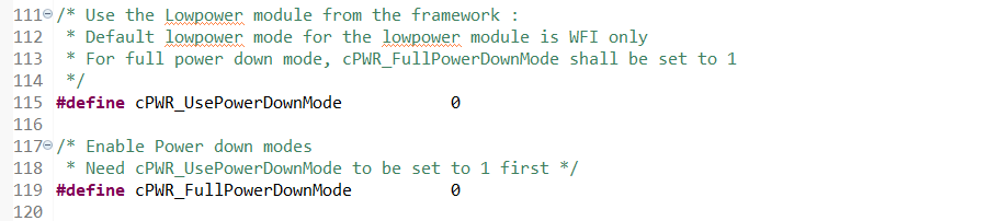

In order to print the relevant data in console, it may be necessary to disable Power Down mode in app_preinclude.h file. This file can be found inside source folder. For this, cPWR_UsePowerDownMode and cPWR_FullPowerDownMode should be set to 0.
Now, after connection, every time that you press the User Interface Button on QN9090 Humidity Sensor is going to send the value to QN9090 Humidity Collector.
  • Humidity Sensor
  • Humidity Collector
