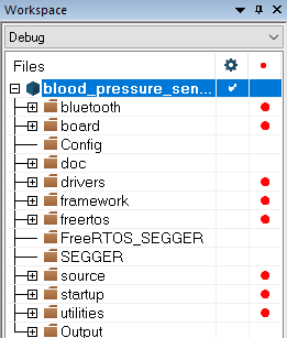

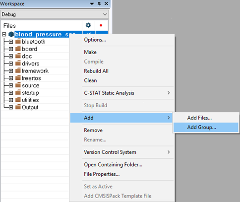

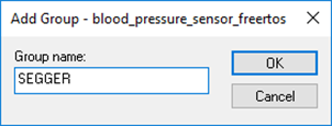

2. Select the project in the workspace, press the right mouse button and select “Add->Add Group...” option
3. Create a new group called “SEGGER”, click on the “OK” button. Repeat the step 1 and create other groups called “Config” and “FreeRTOS_SEGGER”.
The workspace will be updated as shown below

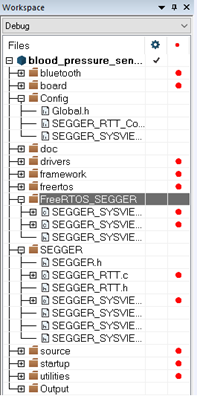

6. Go to the workspace and click the right mouse button on “SEGGER”, “Config” and “FreeRTOS_SEGGER” groups, then select “Add->Add Files...” option. Add the following files:
  • For the SEGGER group:
       All files in <QN9080_SDK_root>/boards/qn908xcdk/wireless_examples/bluetooth/<your_example>/freertos/SEGGER folder
  • For the Config group:
       All files in <QN9080_SDK_root>/boards/qn908xcdk/wireless_examples/bluetooth/<your_example>/freertos/Config folder
  • For the FreeRTOS_SEGGER group:
       All files in <QN9080_SDK_root>/boards/qn908xcdk/wireless_examples/bluetooth/<your_example>/freertos/FreeRTOS_SEGGER folder
The workspace will be updated as shown in the picture below

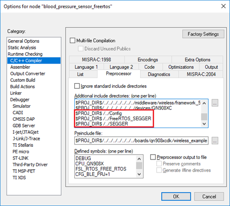

7. Select the project in the workspace and press Alt + F7. Go to “C/C++ Compiler” window and select “Preprocessor”. Include in “Additional include directories” view the following paths:
  • $PROJ_DIR$ /../Config
  • $PROJ_DIR$ /../FreeRTOS_SEGGER
  • $PROJ_DIR$ /../SEGGER

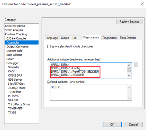

8. Go to “Assembler”, click on “Preprocessor”. Include the last paths on “Additional include directories” view as shown below. Click the OK button.

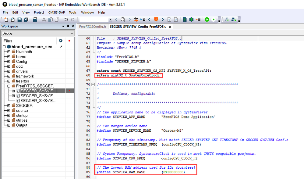

11. Search the “SEGGER_SYSVIEW_Config_FreeRTOS.c” file at FreeRTOS_SEGGER folder in the workspace. Modify the SYSVIEW_RAM_BASE value to the lowest RAM address (default 0x20000000 in QN9080) and add an extern declaration to the SystemCoreClock variable:
extern uint32_t SystemCoreClock;‍‍

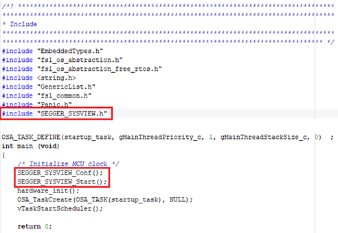

12. Search the “fsl_os_abstraction_free_rtos.c” file at framework/OSAbstraction folder in the workspace. Add #include "SEGGER_SYSVIEW.h" at the top of the file. Search the main function and add the following call to function inside:
SEGGER_SYSVIEW_Conf();
SEGGER_SYSVIEW_Start();‍‍‍‍‍‍‍‍‍‍

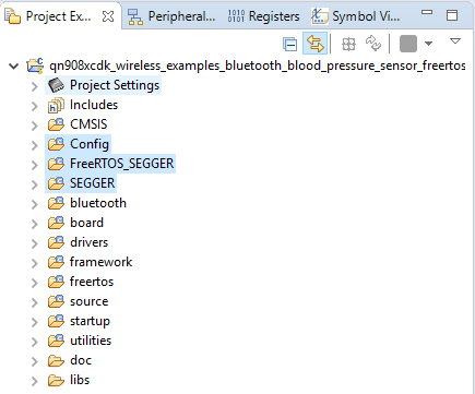

Enabling SystemView in MCUXpresso IDE
1. Install your QN908XCDK SDK in MCUXpresso IDE and import any freertos example from "wireless_examples" folder.

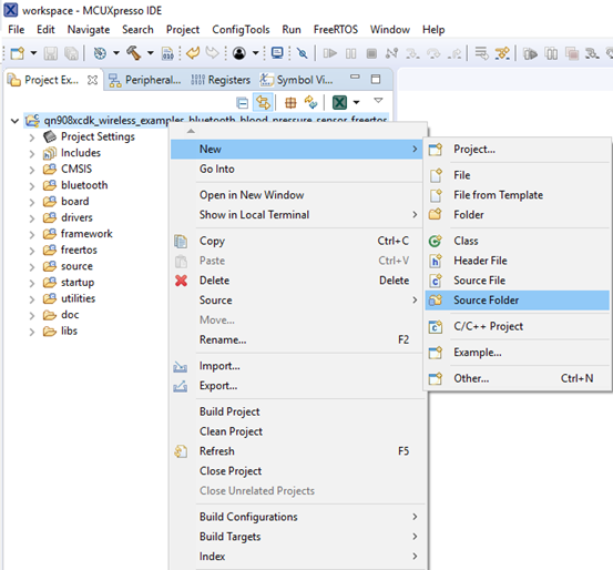

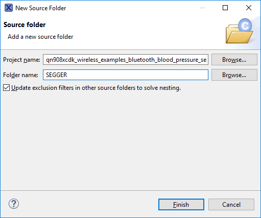

2. Select the project in the workspace, press the right mouse button and select "New->Source Folder" option
3. Create a new folder called “SEGGER”, click on the “Finish” button. Repeat the step 1 and create other folders called “Config” and “FreeRTOS_SEGGER”.

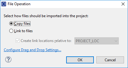

4. Add the following files in the SEGGER, Config and FreeRTOS_SEGGER folders on the workspace dragging and dropping (the default SysView installation path is C:\Program Files (x86)\SEGGER\SystemView_V252c):
  • For the SEGGER folder:
       All files located at <SysView_installation_path>\Src\SEGGER
  • For the Config folder:
      All files located at <SysView_installation_path>\Src\Config
  • For the FreeRTOS_SEGGER folder:
      <SysView_installation_path>\Src\Sample\FreeRTOSV9\SEGGER_SYSVIEW_FreeRTOS.c
      <SysView_installation_path>\Src\Sample\FreeRTOSV9\SEGGER_SYSVIEW_FreeRTOS.h
      <SysView_installation_path>\Src\Sample\FreeRTOSV9\Config\SEGGER_SYSVIEW_Config_FreeRTOS.c
When dragging and dropping, a new window will appear. Select "Copy files" in the button group and click "OK".

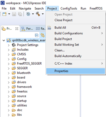

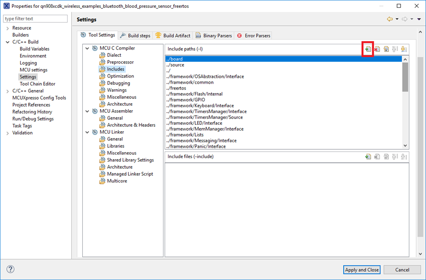

5. Select the project in the workspace, then go to "Project->Properties". The project properties window will be deployed.

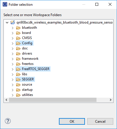

6. Go to "C/C++ Build->Settings->Tool Settings->MCU C Compiler->Includes" view. Click on the "Green plus icon" in the "Include paths" view. A new window will appear, click on "Workspace..." button.
7. Select SEGGER, Config and FreeRTOS_SEGGER folders and click "OK", then click "Apply and Close" in the Project Properties window.

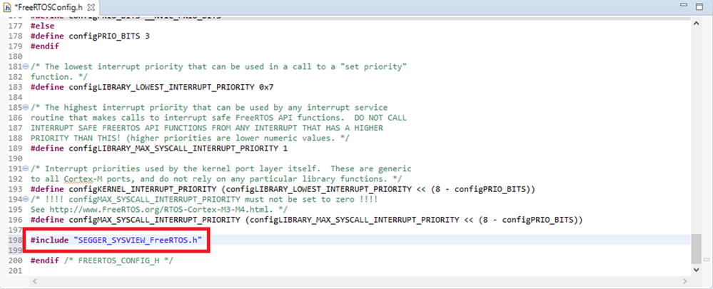

9. Add #include "SEGGER_SYSVIEW_FreeRTOS.h" at the end of the FreeRTOSConfig.h file located at source/FreeRTOSConfig.h in the workspace.

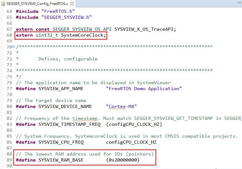

10. Search the “SEGGER_SYSVIEW_Config_FreeRTOS.c” file at FreeRTOS_SEGGER folder in the workspace. Modify the SYSVIEW_RAM_BASE value to the lowest RAM address (default 0x20000000 in QN9080) and add an extern declaration to the SystemCoreClock variable:

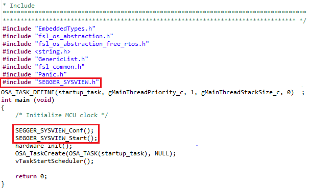

11. Search the “fsl_os_abstraction_free_rtos.c” file at framework/OSAbstraction/Source folder in the workspace. Add #include "SEGGER_SYSVIEW.h" at the top of the file. Search the main function and add the following call to function inside:
SEGGER_SYSVIEW_Start();‍‍‍‍‍‍‍‍‍‍‍‍
