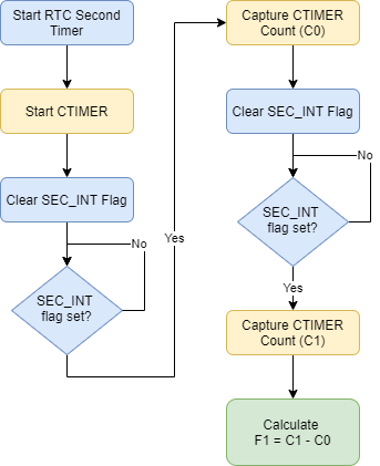

The RTC Seconds Timer uses the 32 kHz clock source as a reference. It contains an internal 32000 cycles counter that increases each 32 kHz clock period. On overflow, it rises the SEC_INT flag to indicate that one second has elapsed.
The CTIMER makes use of the APB clock which derives from the 32 MHz / 16 MHz clock. This timer is used in free-running mode with a Prescaler value of 1 to count the number of APB pulses.
The algorithm consists of counting the amount of APB pulses (trusted clock reference) elapsed by the time the RTC SEC_INT flag is set. Ideally, if both clocks are in the right frequency, the number of APB pulses must be equal to the reference clock frequency. For example, if the APB clock is 16 MHz, by the time the SEC_INT flag sets, the CTIMER counter must have a value of 16 x 106 counts. Assuming our reference clock is ideal, the difference between the CTIMER counter value and 16 x 106 can be used to obtain the ppm difference given the following formula.
Where f0 is the ideal APB frequency (16 MHz) and f1 is the real measured frequency (CTIMER counter value). Since the pulses counted using the CTIMER correspond to the time it took to the RTC Seconds Timer to count one second, we can extrapolate the obtained ppm value as a difference in the 32 kHz clock source from the ideal 32 kHz.
To prevent from any application or task servicing latency, the algorithm makes use of the DMA to automatically capture the CTIMER Counter value when the SEC_INT flag is set. The program flow is described in the diagram below.

OSC_32K_CAL_GetPpm is called every time the ppm value of the 32 kHz source clock needs to be calculated. It takes around one second to complete (depending on how off the 32 kHz source clock is from the ideal frequency) and the application cannot enter into low power state during this time. The registered callback function is executed once the calculation is complete.
The ppm calculation is performed into the DMA callback. It consists of obtaining the CTIMER counter difference and use it as f1 in the formula shown before. The ppm values are calculated using floating point unit.
