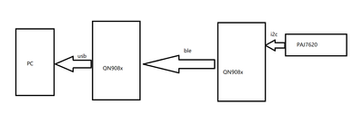

1 Introduction
Two development boards transmit control information through ble. One development board connects to paj7620 and provides gesture information through IIC bus. The other development board uses ble and USB HID. Ble is used to receive data, and USB HID is used to simulate keyboard input and control ppt
                 Figure  1

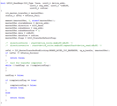

We want to implement IIC to read gesture information from paj7620 and send data.

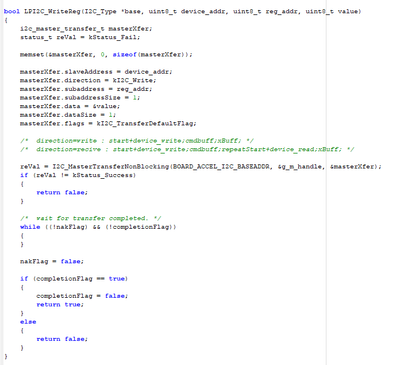

The pins used by IIC are PA6 and PA7
Simply encapsulate the IIC reading and writing code in the code to create i2c_ operation.c and i2c_ operation.h. Realize IIC initialization and reading / writing register function in it
                       Figure  2
                       Figure  3

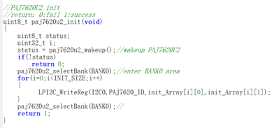

Wake up paj7620 to read device state
                   Figure 5
Initialize device
                   Figure 6

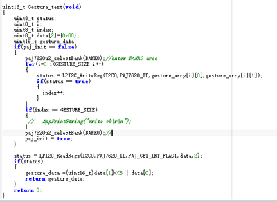

Gesture test function
                                  Figure 7

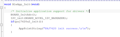

3.1.2 When you are ready to read the device information,
You should initialize IIC and paj7620 in BleApp_Init function
                               Figure 8

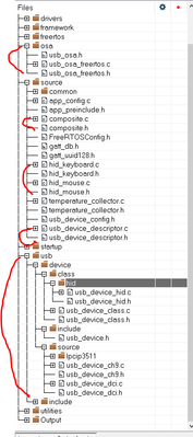

3.2.1 Add the OSA and USB folder under the example to the project directory, and copy the file to the corresponding folder according to the file structure of the original example.
                     Figure 11

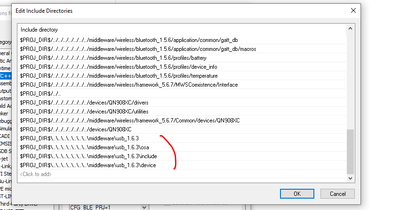

3.2.2 Add header file directory after completion
                                          Figure 12
At the same time, in this tab, add two macro definitions
USB_STACK_FREERTOS_HEAP_SIZE=16384
USB_STACK_FREERTOS

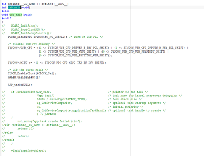

3.2.3 Next, we need to modify the main function in usb example . Open composite.c file.
                     Figure 13
It calls the APP_task. So this function also need to be modified.
                                  Figure 14

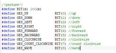

3.2.4Find hid_mouse.cComment function USB_DeviceHidMouseAction
Find hid_keyboard.h. Define the gesture information.
                                Figure 15

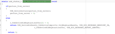

Find hid_keyboard.c. We need to modify the function USB_DeviceHidKeyboardAction as following figure.
                                                 Figure 16
Among them, we also need to implement the following function. When the up hand gesture is detected, the previous ppt will be played. The down hand gesture will be the next PPT, the left hand gesture will exit PPT, and the forward hand gesture will play ppt
                                                 Figure 17
It also refers to an external variable gesture_from_server. The variable definition
is in file temperature_ collocation.c,.

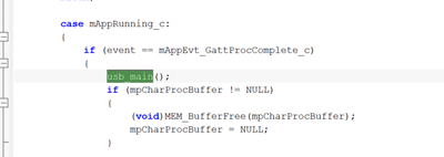

3.2.5 After that, let's go to BleApp_Statemachinehandler function
in temperature_colloctor.c.
In case mApppRunning_c, we will call usb_main to initialize USB HID
                                                 Figure 18

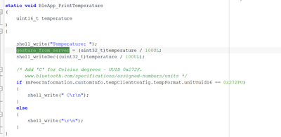

3.2.6 In BleApp_PrintTemperature, we will save the gesture data to gesture_from_server
                                                        Figure 19
