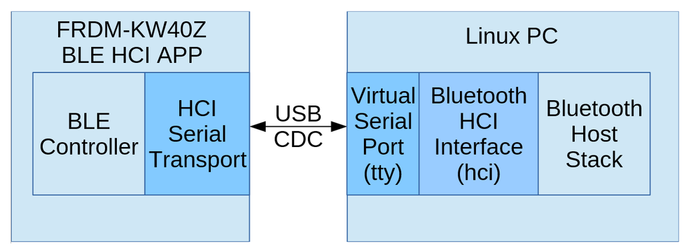

The Bluetooth specification has a very well defined interface between the Controller and the Host called the HCI (Host Controller Interface). This interface is defined for and can be used with various transport layers including an asynchronous serial transport layer.
A typical scenario of Bluetooth Low Energy hardware use is a development board which has a BLE Controller accessible via serial transport HCI connected to a device on which the BLE Host runs. The device which runs the BLE Host can be any type of embedded device or a PC. PCs running a Linux type OS can use the hcitool from the Linux Bluetooth Stack to interact with a BLE Controller via the HCI interface. The particular use case of  FRDM-KW40Z board with a serial transport HCI interface running over USB CDC and connected to a PC running the Linux Bluetooth stack is shown in the diagram below and will be detailed din the following sections.
Figure 1FRDM-KW40Z (BLE Controller) connected to Linux PC (Bluetooth Host Stack) via HCI Serial Transport

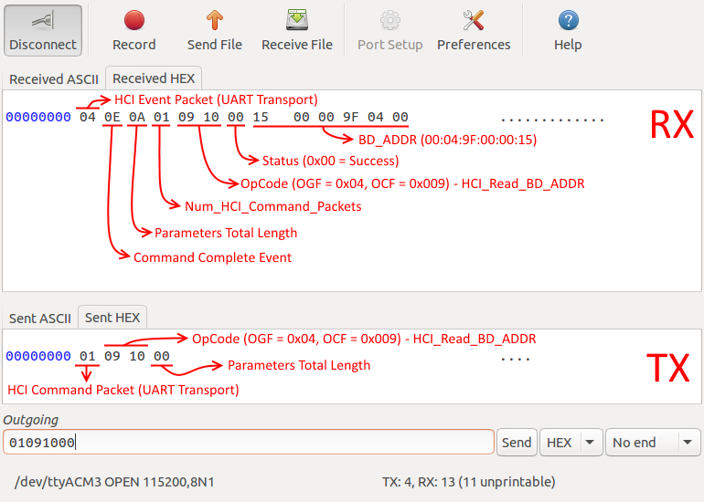

To test the connection some HCI commands can be sent in hex format from any terminal application to the serial HCI on the FRDM-KW40Z board.
In the figure below an HCI_Read_BD_ADDR command and its corresponding Command Complete Event are shown as they were sent and received in hexadecimal format from the moserial serial terminal GUI application.
Figure 2: HCI command and response event in hexadecimal format (HCI UART Transport)
