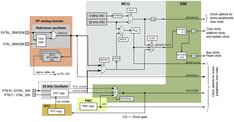

If the application running in the KW41Z does not operate in low power mode, the device could work without the 32 kHz oscillator. However, for it to work correctly, the clock configuration must be changed.
Figure 1.  KW41Z clock distribution
By default, the software stack running on the KW41Z selects a clock source that requires the 32 kHz oscillator. However, if the 32 kHz oscillator is not available, the clock configuration must be changed. Fortunately, the option to change it is already implemented, it is only required to change the clock configuration to the desired one. To do this, change the value for the CLOCK_INIT_CONFIG macro located in the app_preinclude.h file.
/* Define Clock Configuration */
#define CLOCK_INIT_CONFIG           CLOCK_RUN_32‍‍‍‍‍‍‍‍‍‍
In the selected mode in this example, CLOCK_RUN_32, the selected clock mode is BLPE (Bypassed Low Power External). In this mode, the FLL is bypassed entirely, and clock is derived from the external RF oscillator, in this case, the 32 MHz external clock.
These macros are the default available options to change the clock configuration, they are located in the board.h file. It is up to the application and the developer to chose the most appropriate configuration.

More information regarding the different clock modes and their clock sources are available in the KW41Z reference manual, Chapter 5: Clock Distribution, section 5.4 Clock definitions, and Chapter 24: Multipurpose Clock Generator.
