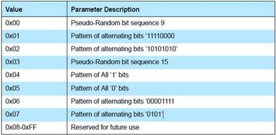

  3.       Send the next command in Hex format “01 1E 20 03 26 20 00”. It is to set the radio in Transmit test mode. The number 26 specifies the number of the channel in which user wants to see the signal(valid range is from 0x00 to 0x27, this means from BLE Channel 0 to BLE Channel 39). Number 00 specifies the type of the signal that will be sent, in this case, it is a PBRS9 format. (valid range are from 0x00 to 0x07). Refer to the next table to know the meanings of each type of signal.  Finally, 20 is the number that specifies the length that will be sent in the packet or the payload, in this case, it is configured to 20 (32 bytes), VALID RANGE is from 0x00 to 0x25.

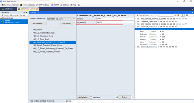

hi miguel,
can you tell me  parameter tx_power's range in HCI_VENDOR_CONFIG_TX_POWER command?
thanks.
Hi @EverettRao ,
The format of the command in the xml file is wrong.
Please update the XML file for this command as below:

On TestTool, you should see something like this:
As parameters, there are 2 options for the channel:
  • 0x00 – advertising channel;
  • 0x01 – connection channel;
And the tx_power is the level in dbm.  If you put a value > 20 you will receive COMMAND_DISALLOWED_ERROR.
