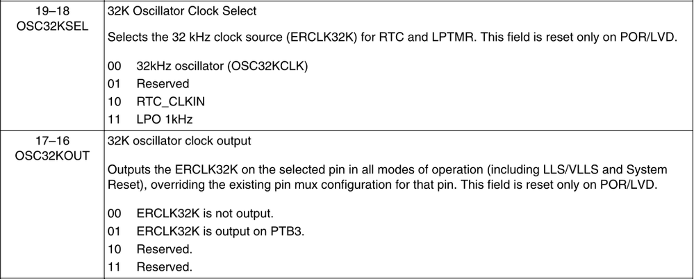

2.  Modify the System Options Register 1 (SIM_SOPT1) to select the clock source and to allow the selected clock source to be output in PTB3. The field you should change is OSC32KOUT. To select the clock source to be output on PTB3, use the function CLOCK_HAL_SetExternalRefClock32kSrc(). Remember to include the fsl_sim_hal.h file.
Figure 3. SIM_SOPT1 register fields

SIM_Type *simBase = g_simBase[0];
SIM_SOPT1 = SIM_SOPT1_OSC32KOUT(kClockRtcoutSrc32kHz);                // This field in register SIM_SOPT1 allows a clock source to be output to PTB3
CLOCK_HAL_SetExternalRefClock32kSrc(simBase, kClockEr32kSrcOsc0);     // This function chooses the clock source for the RTC
