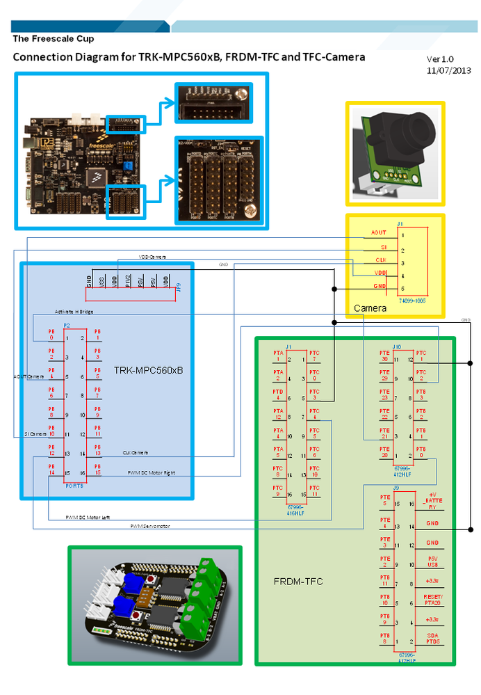

Wire diagram for the TRK-MPC5604B

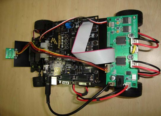

Connection Diagram for TRK-MPC5604B to Rev. 1 Motor Control "Shield" Board
Connection Diagram for TRK-MPC5604B to Rev. 0 Motor Control Board TFC_ConnectorsAndCables.png

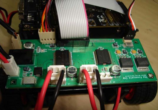

For the TRK-MPC5604, connect the flat ribbon cable to PortB as seen in the picture below.
Make the cable connections as shown below for dual motor with independent drive
connection
Make the cable connections as shown below for dual motor with series drive connection
Make the cable connections as shown below for Single motor connection

What mean ENDL and ENDR???
Are the pins for activate the left dc motor( ENDL ) and activate the right dc motor (ENDR), if this is true, then the PWML and PWMR are the inputs pins for the input PWM signal for each dc motor respectively ????
greetings...
ENDL = Enable Drive Left
ENDR = Enable Drive Right
Basically enable pins (On or Off).  The control signals is the PWML & PWMR.
