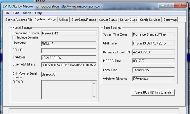

The IP is defined by the LMtools.
On my side it's:
When I generate the license file I need to use the Hostname or IP Address as server name.
For instance I could have a floating license as:
          SERVER R6AAKE-12 DISK_SERIAL_NUM=daae9c76 27001
or      SERVER 10.213.33.166 DISK_SERIAL_NUM=daae9c76 27001

I was in contact with colleague (Tomas) regarding this problem.You were in contact with Tomas regarding this question
By design FNP will select the default ip address that the OS gives to it a as the address to connect on.
I don't know of a way within FNP to change this.
I did a bit of research and there is a discussion on this topic in a forum that I found:
Take a look to this community  post
  http://serverfault.com/questions/119840/windows-server-2008-specifying-the-default-ip-address-when-n...
