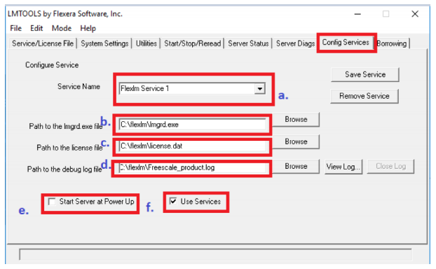

3. Open LM Tools / Go to Config Services tab ![pastedImage_13.png pastedImage_13.png](/t5/image/serverpage/image-id/88801i625F0C070B90D539/image-size/large?v=v2&px=999)
- Service Name: Please type a new service name.
- Path to the license: select the location of the license file.
- Path to log file: create a file to save the log file from server.
- Uncheck Start Server at power-up.
- Check Use Service.

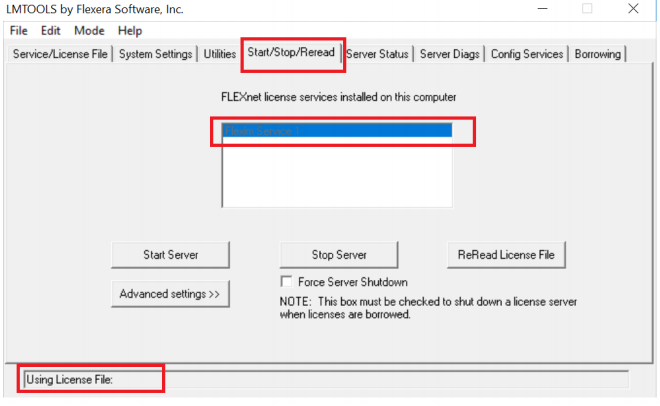

4. Open Start/Stop/Reread tab
- Select the new created service and click on reread License file.
- Check on the license status on the low left side of the windows. License read successfully is expected.
