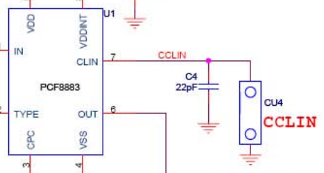

5) "CCLIN determines the internal sampling frequency and therefore the reaction time of the switch. Smaller values of CCLIN correspond to shorter reaction times."  Shorter reaction times correspond to higher sampling frequencies, so I should increase Clin for a lower sampling freq observing 0nF(min), 22(typ), 100pF(max).  So, to get a larger value, I can leave the existing CCLIN and place and another capacitor between the CU4 holes/pads, since parallel capacitances are cumulative.

Thanks for your reply.  In my copy of UM10370 (and presumably also upon my demo evaluation board), there is an installed 22pF capacitor for C4 (not 0.22pf - two orders of magnitude larger) and an additional CCLIN can be placed at CU4 and those two are connected to CLIN pin 7.  And the 'Optimize step by step' section lists a min(0pF), typ(22pF), max(100nF) for CCLIN.  I assume the 100nF is a typo and it really means 100pF.  You surely mean C5 and not C4 if our documents are the same.  Anyway, I'm currently at 22pF for CCLIN (C4) as I think you recommend and CU4 is currently unpopulated.  Since parallel capacitances are cumulative, I would need to cut the trace to C4 to try a lower value capacitance, and will try that if you still recommend it if you agree with this paragraph.

You are correct, sorry about that, I was referring to the C5 (CCLIN) capacitor, and I checked and it is 22pF for a sampling rate of 1 kHz already.
