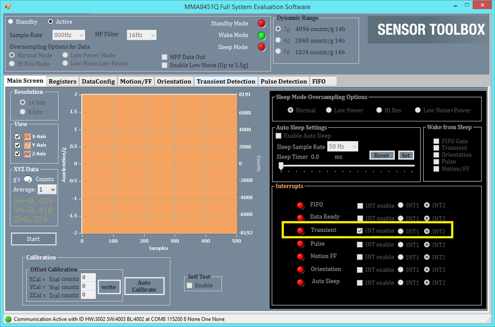

Hi, I am testing functions of MMA8451Q following user's guide and facing day1 problems...
1) Enabling Latch
the sensor does not work appropriately when the latch is enabled and Transient Interrupt is selected. My understanding is in the indicator light in the main screen shouldn't flip or stay red if the Transient detection tap is read.
figure1: Transient interrupt is sold red/flipping green (occassionally) as I shake the sensor (Threshold was set very low 0.6g).
2) Also, Directional Tap Low-Power with FIFO application never work. I set the values and ran active mode, tapped sensor, but nothing happens.. (Although tap is detected in Full System Evaluation application) .
figure2: Active mode and nothing appears (using MMA8451Q).

Hi Robin,
We have been doing some testing here and we believe the issue is a software (rather than hardware) issue.
We have been able to reproduce it on a machine here but we are still trying to figure out why it works on some machines and not others. I will let you know as soon as we make some progress but it may take some time as the issue is intermittent.

troydaniel
Hi Robin,
The transient detection function is actually intended for the detection of "shake" events rather than 'tap" events, if you wish to detect single/double-tap events you may be better served by the "Pulse Detection" function of the demo.
Unfortunately the demo is not the best way to examine the Latch function. Since the Latch function holds the event active until the transient interrupt source register (TRANSIENT_SRC) is read (which it must be to toggle the indicator light in the GUI) the indicator will only toggle to green briefly (as the interrupt that toggles it also clears the bit and toggles it back to red), as such the Latch will never really be visible via the GUI.
I am currently unable to reproduce your issue with the Tap detection, I have tested it on two PCs here and both work out of the box with an 8451Q, do you have the latest version of the STB 4.2.1.17?
Hope this is helpful, please reply if you have any further questions or concerns.
Troy
