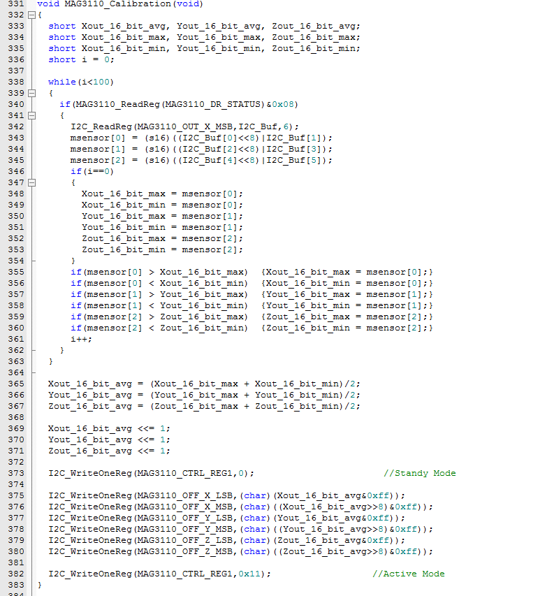

   i use the calibration way refer to the demo. But i don`t know why this way can calibration, if i am wrong. how i can use mag3110 enbedded offset?
   the screenshot is my calibration way

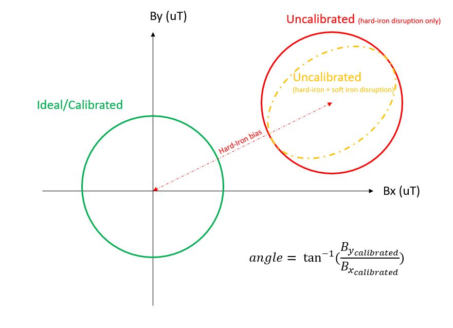

This software function is supposed to calibrate the HardIron (offset brought by the board and the magnetometer). But this will work with one essential condition : you need to rotate the board/MAG31110 over the 3-axis during the execution of the calibration !
Look at the chart below (here, the board rotates at a constant speed, but you don't need to do that)
By rotating the magnetometer, you will change the magnetic field (induced by the Earth, like a compass). By capturing the min and max values, you will by able to calculate the offset of the MAG3110. By writing theses values in the OFF_axis_xSB register, the MAG3110 will be able to apply this hardiron vector compensation to the raw measurements: that's the calibration.

With the additional information I give to you, you should be able to understand how to do it : use the hardiron calibration, then apply arctan(Y/Z). You have all the pieces, you just need to merge it altogether.
