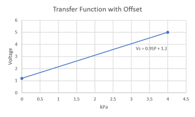

Thank you for the response. I have since connected the breakout board and ADC with the Raspberry Pi and am getting readings. However, I am a little confused by the output.
I am getting the output by calling the 16-bit channel.value and channel.voltage of the ADC as per this tutorial. At no pressure difference between the ports I typically read the following:
Raw ADC Value: 23808
ADC Voltage: 1.20529
Is this a typical offset for this type of sensor? Can I use this 0.2V offset to use the following formula (V = 0.95P + 1.2) from the plot below to convert to kPa? Or would you recommend a different method?
Thanks again for your help.
Kind regards,
Tillman
1,495 Views
TomasVaverka
Hi Tilman,
Yes, as you can notice in the datasheet (Table 3), the offset can be anywhere between 0.75V and 1.25V.
The sensitivity is 1V/kPa, so I would recommend to use the following formula:
Vout = P + 1.2 => The max pressure the sensor will be able to measure is about 3.8 kPa.
