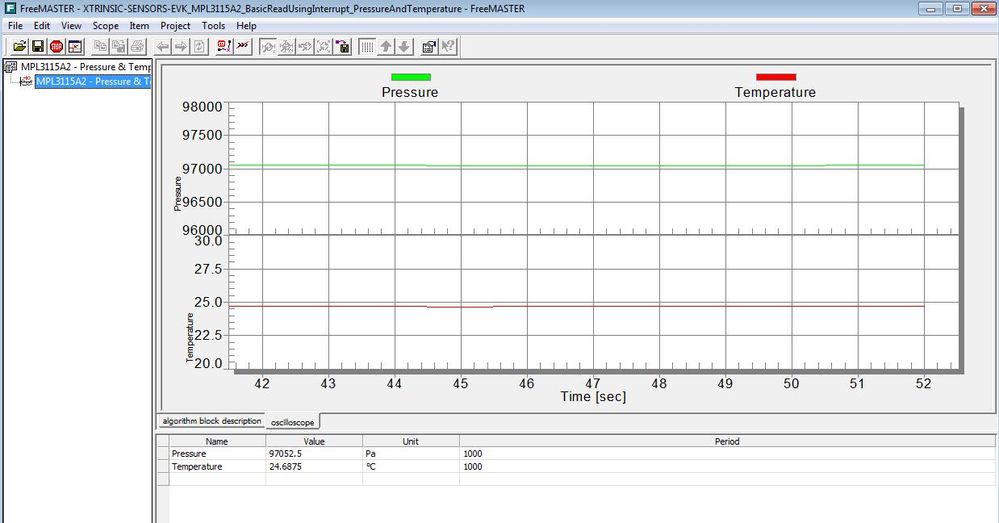

In one of my previous documents I presented a simple example code/demo that reads both the altitude and temperature data from the Xtrinsic MPL3115A2 pressure sensor and visualizes them using the FreeMASTER tool via USBDM interface. This time I would like to share another example with the MPL3115A2 programmed to measure pressure (barometer mode) and temperature. The Freescale FRDM-KL25Z board coupled with the Xtrinsic MEMS sensors board was used for this project.
The initialization of the Kinetis KL25Z128 MCU remains the same, the only small change is in the initialization of the MPL3115A2, this time the barometer mode is selected with the OSR of 128.

As usual, the calculated values can be watched in the "Variables" window on the top right of the Debug perspective or in the FreeMASTER application.
The complete source code written in the CW 10.3 as well as the FreeMASTER project is attached to this document.
