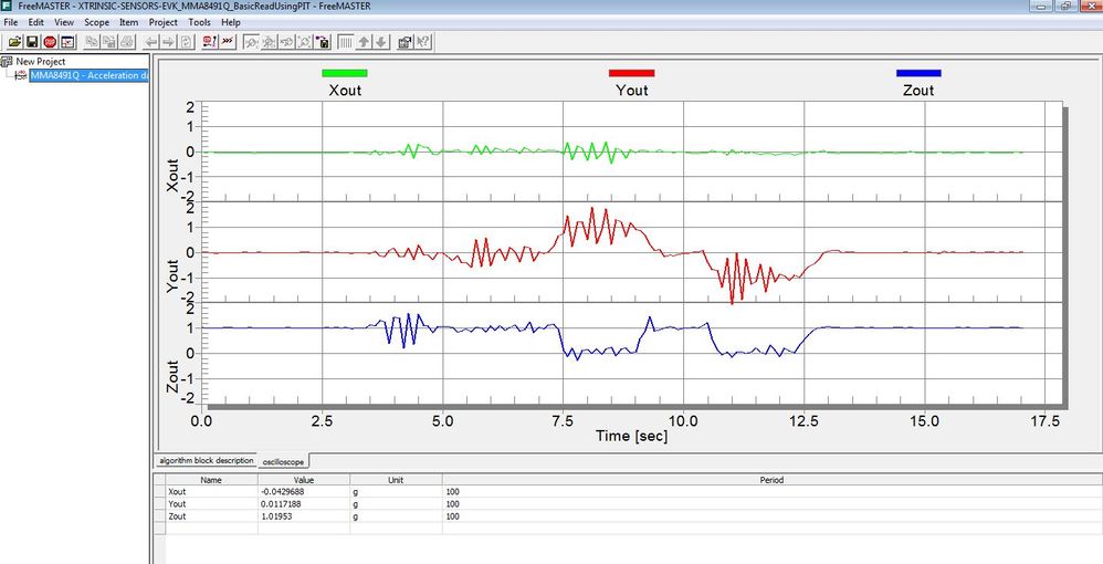

I would like to present another example code/demo that reads acceleration data from the Xtrinsic MMA8491Q digital accelerometer and visualizes them using the FreeMASTER tool via USBDM interface. I have used recently released Xtrinsic MEMS sensors board that features three types of Xtrinsic sensors including the MMA8491Q and is fully compatible with the Freescale FRDM-KL25Z platform.
In comparison with other Xtrinsic accelerometers, the MMA8491Q is turned on at the rising edge on the EN pin and acquires only one sample for each of the three axes. It does not have any interrupt pins, instead there are three push-pull logic outputs which provide tilt detection at 45 degrees as the original target application was tamper detection. However, it is possible to read the 14-bit output values through the I2C port as demonstrated in my example below.
According to the User Manual, both SCL and SDA lines are connected through the 4.7K pull-up resistors to the I2C1 module (PTE1 and PTE0 pins) on the KL25Z128 MCU and the EN pin is connected to the PTA13 pin. The EN input needs to be kept high until a new data is ready (max. 900us) and read. In my code I use the PIT module to wait 1ms before reading the output values. This timer is also used to read the output data periodically at a fixed rate. The timeout period of the PIT is set to 500us. The MCU is, therefore, configured as follows:

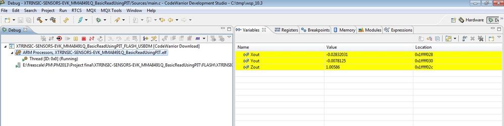

The calculated values can be watched in the "Variables" window on the top right of the Debug perspective or in the FreeMASTER application.

I am trying to visualize the similar kind of thing using KL25Z board in FreeMaster. But the communication which i have used is through OpenSDA. The problem here is when i tried to plot the graph for  Xout_g, Yout_g and Zout_g i am getting some odd values for these variables. Is there any thing that i need to set to display those variables in terms of g.
Hi Charan,
I have also used the OpenSDA connection for this project. To display the Xout_g, Yout_g and Zout_g variables properly, make sure the Floating point IEEE type is selected (right click on the variable – Edit variable… - Variable Type = floating point IEEE, Size = 4 bytes).
Hope it helps.
Tomas
Hi Thomas,
Thank you very much for your replay. I made that change and now it works fine.
Charan
