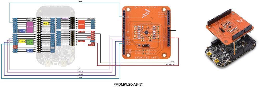

1. As you can see in the FRDMSTBC-A8471/FRDM-KL25Z schematics and the image below, SPI signals are routed to the SPI0 module of the KL25Z MCU and the INT1 output is connected to the PTD4 pin. The PTD0 pin (Chip Select) is not controlled automatically by SPI0 module, hence it is configured as a general-purpose output. The INT1 output of the FXLS8471Q is configured as a push-pull active-low output, so the corresponding PTD4 pin configuration is GPIO with an interrupt on falling edge.
The configuration is done in the BOARD_InitPins() function using the NXP Pins Tool for Kinetis MCUs.

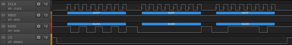

2. The falling edge on the CS pin starts the SPI communication. A write operation is initiated by transmitting a 1 for the R/W bit. Then the 8-bit register address, ADDR[7:0] is encoded in the first and second serialized bytes. Data to be written starts in the third serialized byte. The order of the bits is as follows:
Byte 0: R/W, ADDR[6], ADDR[5], ADDR[4], ADDR[3], ADDR[2], ADDR[1], ADDR[0]
Byte 1: ADDR[7], X, X, X, X, X, X, X
Byte 2: DATA[7], DATA[6], DATA[5], DATA[4], DATA[3], DATA[2], DATA[1], DATA[0]
The rising edge on the CS pin stops the SPI communication.
Below is the write operation which writes the value 0x3D to the CTRL_REG1 (0x3A).

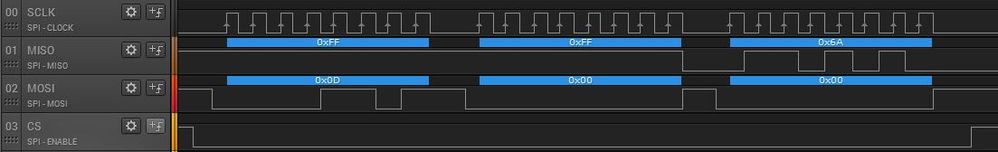

Similarly a read operation is initiated by transmitting a 0 for the R/W bit. Then the 8-bit register address, ADDR[7:0] is encoded in the first and second serialized bytes. The data is read from the MISO pin (MSB first).
The screenshot below shows the read operation which reads the correct value 0x6A from the WHO_AM_I register (0x0D).

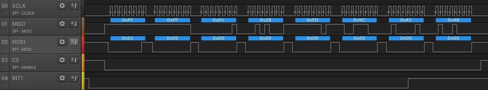

Multiple read operations are performed similar to single read except bytes are read in multiples of eight SCLK cycles. The register address is auto incremented so that every eighth next clock edges will latch the MSB of the next register.
A burst read of 6 bytes from registers 0x01 to 0x06 is shown below. It also shows how the INT1 pin is automatically cleared by reading the acceleration output data.

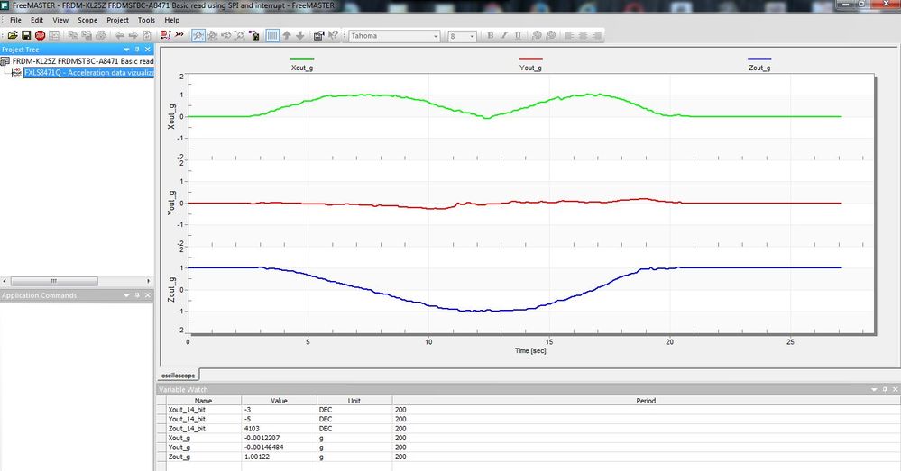

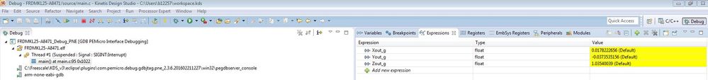

6. The calculated values can be watched in the Debug perspective or in the FreeMASTER application. To open and run the FreeMASTER project, install the FreeMASTER 2.0 application and FreeMASTER Communication Driver.
Attached you can find the complete source code written in the KDS 3.0.2 including the FreeMASTER project. If there are any questions regarding this simple application, do not hesitate to ask below. Your feedback or suggestions are also welcome.
