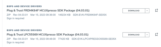

Hi @keerthi1 ,
You may have the source code in the sdk based projects, please kindly refer to the following for details.
Kan
