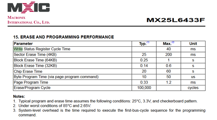

Is there a way that you can offer so that we can handle that much data in that much time. We looked at some external flashes written by QSPI but they handle to save 800kByte arount 2.5sec as well?
3,293 Views
danielmartynek
Hi @Fergani,
It depends of the flash.
For example, on the S32K344 EVBs, there is MX25L6433F
If you have any questions about QuadSPI, please create a new thread.
Thank you,
BR, Daniel

3,310 Views
danielmartynek
Hi @Fergani,
This is within the specs of the flash, it can't get faster than that, unfortunately.
Please refer to the S32K3 datasheet, rev.8.1
Table 29. Flash memory program and erase specifications.
