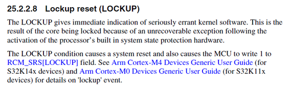

danielmartynek
Hi Artem,
By the lockup do you mean the core lockup reset?
If so, have you tried using the HardFault exception handler and find the cause of the exception?
