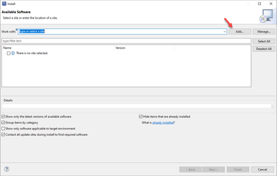

i have s32ds 3.5 and i'm using the board MCTPTX1AK324(and follow step provided to get started) with installation RTD 4.4 2.0.0,  IPCF 4.0.0.
I have tried to install sw32k3_FreeRTOS_10.4.6_2.0.0_D2204 and i following these steps on s32ds 3.5:
1)Open Window->Preferences. From next windows, select S32 Design Studio for S32 Platform-> S32DS Extensions and Updates, click Add All and select zip archive sw32k3_FreeRTOS_10.4.6_2.0.0_D2204
2)Help -> S32DS Extensions and Updates. At this point a window appears indicating unsuitable package(i have include image in the attachment) . The question is: which version of FreeRTOS should i download to be compatible with RTD 2.0.0 and s32ds3.5?
Thanks in advance for any help and info
10,109件の閲覧回数
VaneB

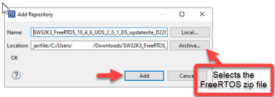

Hi @michelet1
Could you validate if the following works for you?
VaneB_5-1699904498843.pngVaneB_5-1699904498843.png VaneB_6-1699904557577.pngVaneB_6-1699904557577.png
VaneB_7-1699904595385.pngVaneB_7-1699904595385.png VaneB_8-1699904643929.pngVaneB_8-1699904643929.png
You need to accept all the terms and conditions, and if the package is correctly installed S32DS will ask you to restart.
B.R.
VaneB

10,097件の閲覧回数
michelet1
Thanks for the reply. I tried to follow the steps you indicated and i actually managed to install freertos.
