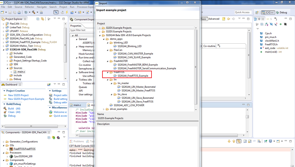

martin_kovar
please open FreeRTOS example from SDK software example list (click File->New->New S32DS project from Example) and choose S32K144_FreeRTOS_Example. Please see the figure below.
Compare, what is different in your project.
Martin

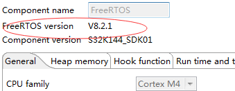

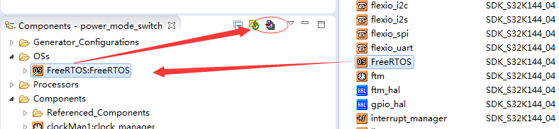

eautopower
HI Martin:
  thank you for your answer,My configuration parameters as same as the  S32K144_FreeRTOS_Example,but i find a difference is the FreeRTOS version,the Example version is V8.0.0,and my version is V8.2.1
Please see the figure below:
My project  compiler error like this:
Xie

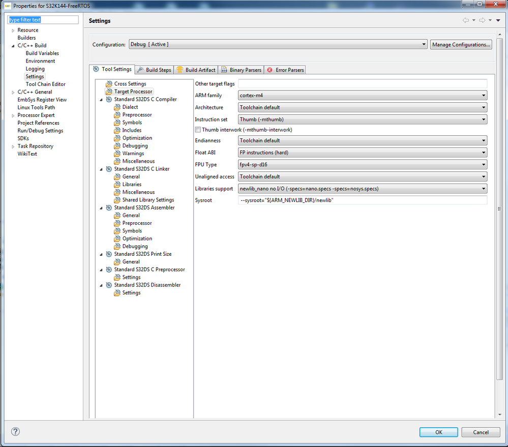

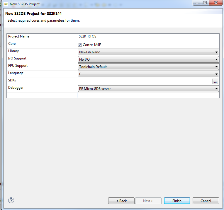

martin_kovar
Hello Xie,
at first, when you create new project, you must choose newlib_nano library
Then look at the project settings:
If you use the same settings as in the figures above, you should be able to compile the project.
Martin
