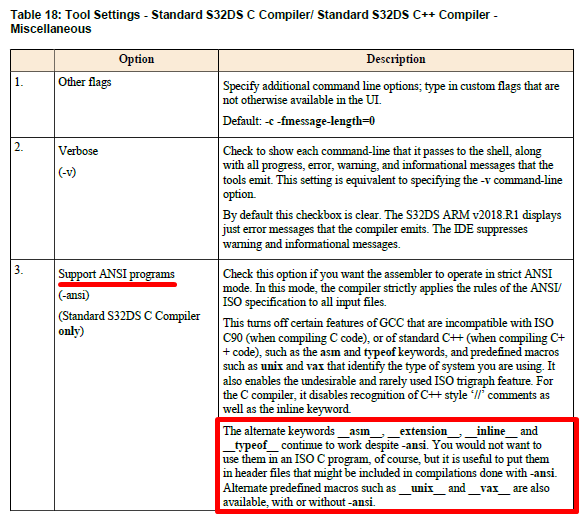

momo12
where is the documentation for things like that?
3,374 Views

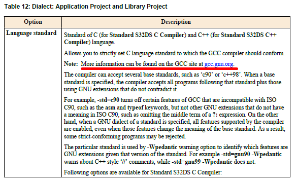

danielmartynek
You may refer to Document arm_pdf_reference.pdf
In the S32DS installation folder …\S32DS_ARM_v2018.R1\S32DS\help\pdf\
More information can be found here:
https://gcc.gnu.org/onlinedocs/gcc/Extended-Asm.html
