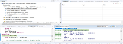

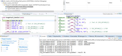

Hello @danielmartynek
i add the example code, i find the is the when open printf in task, it will cause this issue.
but i didn't see the issue in printf function, attached is the project, can you help to check it, thank you!

xQueueSend( xQueue, &ulValueToSend, mainDONT_BLOCK );
printf("prvQueueReceiveTask=%d\n",i);
// vTaskDelay(pdMS_TO_TICKS(10));
vTaskDelayUntil( &xNextWakeTime, mainQUEUE_SEND_FREQUENCY_MS );

xQueueReceive( xQueue, &ulReceivedValue, portMAX_DELAY );
i++;
//vTaskDelay(pdMS_TO_TICKS(10));
