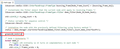

am trying to use a Segger J-Link debugger with ‘S32 Design Studio for Arm IDE’.
I am using a ‘UCANS32K146’ evaluation board which has a S32K146 processor.
I set a breakpoint as shown...
But the debugger does not seem to run to or stop at the break point, it seems to be in reset ?

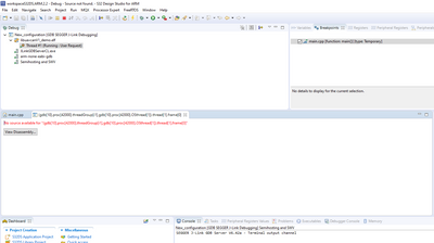

Below is a copy of the console messages...

The Segger control panel shows the following...
The LED on the Segger looks to be orange/red (its hard to tell) which means its either in reset or there's a fault.
A screenshot of the IDE during debugging is shown below...
I was expecting the IDE to stop at that breakpoint so I could step through the lines of code.

Could you help us sharing the last image with higher quality? We are not able to distinguish the red text on the one you have provided.
Also, we are seeing that Segger may not have support for our IDE:
J-Link: Supported IDEs Overview (segger.com)
Since the UCAN platform contains an S32K1 MCU, these are commonly bundled with either PE Micro or an OpenSDA connection, but not a JLink.
By seeing your log, it seems that the JLink could not halt the MCU, which does not allow to debug. Have you previously used this tool with an S32K1 MCU? Or is this the first time?

Apologies for the poor resolution images, please find better images attached
This is the first time I have used the Segger with this IDE and S32K processor.

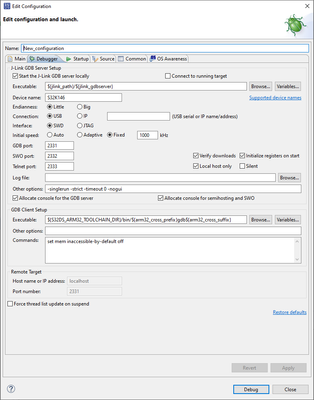

How are you building the application? We are seeing there are different build configurations.
Also, how are you configuring the "Main", "Debugger" and "Startup" tabs inside the debug configuration window?
Under the S32K1 provided SDK's there seems to be ready to use JLink configurations, which should provide you with a usable debug configuration. You could try and use one of the out-of-the-box examples to see if the behavior remains the same.
Please, let us know.

I build as shown in the screenshot below (Node_A_Debug)...
The "Main", "Debugger" and "Startup" tabs inside the debug settings is shown below...
I downloaded and installed "S32_SDK_S32K1xx_RTM_4.0.3" and imported the example '\adc_low_power' but this won't even build as it gives the error "/bin/sh: arm-none-eabi-gcc: command not found"...

Daniel-Aguirre
Thanks for your feedback.
The SDK that you are trying to import into S32DS for ARM v2.2 is not compatible with that IDE, it is compatible with S32 Design Studio v3.4. That should be why you are seeing that error.
The one that it is compatible with S32DS for ARM v2.2 should be provided with the IDE, image below:
Within the examples provided with the SDK, the following configurations should be provided:
In our specific case, we use the FreeRTOS project as an example. This should be ready to use.
