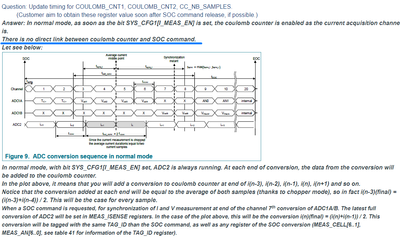

JozefKozon
Hi Venkatesh Vhaili,
I am not sure if we mean the same thing. Could you please explain the meaning of the SOC and SOH abbreviations?
The SOC should be Start Of Conversion. Is that correct? Please see below an answer from an application engineer regarding the coulomb counting and SOC.
With Best Regards,
Jozef

JozefKozon
the SOC means Start Of Conversion. There is no formula/calculation of the SOC. Please refer to the section 9 in the MC33771C datasheet.
On-demand measurement: this means the bank of ADCs perform a sequence when
triggered by a SOC command, where SOC means start of conversion. Typically, the
user periodically sends a SOC command followed by the reading of the measured
values of the most important channels, namely all cell voltages, temperatures and
current.
The MC33771C performs on-demand differential measurements of external inputs and
internal measurements using three ADC converters for measurement, calibration, and
diagnostics. Once the device is initialized, on-demand conversions are initiated by writing
to the ADC_CFG [SOC] convert register or a GPIO2 input trigger.
