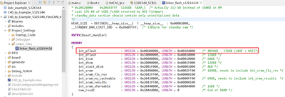

    I just write a project of flexcan0. It  can receive a can messae whose CANID is 0x20. it works well when the PFlash start address is  0x00400000. but it cannot receive the 0x20 Can Message after I changed the PFlash start address to 0x00600000. In addition, I cannot debug the project any more after the PFlash start address changed. when I pressed the debug button, a new window appeared and said "Break at address "0x0" with no debug information available, or outside of program code."

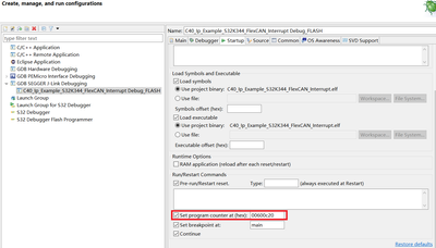

Thank you very much for your rapid reply. I am not familiar with S32DS configuration. I also want to know where and how to config the debug settings in  S32DS.  Although I set the PC(shown in the first picture, I'm not sure whether it's right or not.), it does not work.   Would please tell me how to config the S32DS on the issues above or give me some information?

Setting PC, have no effect at your case. As you need micro to boot from that address after reset. PC will be automatically set at first instruction after reset.
