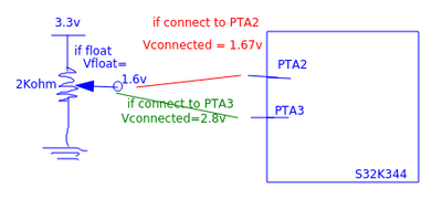

Hello everyone,
We are recently debugging the ADC function of PTA2 and PTA3 for voltage monitoring.
So we configured PTA2 and PTA3 as ADC functions, then used a 2k potentiometer to divide the voltage out to 1.6v, shorted the 1.6v to PTA3 and PTA2 respectively, and expected that both PTA2 and PTA3 could accurately measure about 1.6v.
But the test result is: PTA2 reads about 1.6v, and PTA3 reads about 2.8v. (Whether it is reading the MCU register or using a multimeter to measure the short contact point between the potentiometer and PTA2 or PTA3, the result is the same, so it can be ruled out as a reading error.)
After some attempts, we configured PTA3 as an ADC input and also configured it as a GPIO input as following(Software version: S32DS3.4, RTD 1.0.0).
Then PTA3 can also read the voltage of 1.6v correctly.
Although PTA3 can read the voltage as expected in this strange configuration,
I still don't know what the specific difference is between the two ports when powered on, and how this difference leads to this voltage difference.
I checked the manual and only found that the direct signals of PTA2 and PTA3 are different.
Will there be other risks in how to configure it?

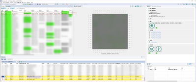

2,174 Views
PavelL
in your screenshot, I see enabled pullup on E16. Please try set GPIO's "Pullup Enable" to disable.
Pavel
2,115 Views
Cheddar
I tried to disable the GPIO's "Pullup Enable," but it didn’t work.
Further investigation revealed that the issue arose because PTA3 was configured as the UART TX pin in the bootloader. During the transition from bootloader to application, the PTA3-ADC configuration failed to properly override the previous PTA3-UART TX settings.
This override failure occurred because when configuring PTA3 solely for ADC function in S32DS and generating code, the tool does not include a PTA3 configuration structure inside the generated
const Siul2_Port_Ip_PinSettingsConfig g_pin_mux_InitConfigArr0[NUM_OF_CONFIGURED_PINS0]
Consequently, during initialization using `g_pin_mux_InitConfigArr0` in application, PTA3 is not reconfigured.
In contrast, if we configure PTA3 for GPIO input function and generate code, S32DS generates a configuration structure for PTA3.
Currently, the best solution I can think of is:
1. Configuring pins used as ADC to be both GPIO inputs and ADC functions.
2. Restoring all configurations to their default settings before the bootloader jumps to the application.
However, we haven't found a function in the RTD library that deinitializes all GPIO configurations.
Is there a better method or a register that can reset all configurations (not only GPIO) without resetting the MCU?
Since the MCU always starts from the bootloader and then transitions into the application, resetting the MCU won’t effectively reset all configurations needed for the application in this case.
