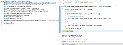

When performing Power_Ip_SetMode during initialization,
the time of OsIf_Timer_System_Internal_GetElapsed is not counted.
Where should I check?
SYSTICK_GET_COUNTER() value does not count.
I have an environment of S32DS 3.5, S32K324, RTD 4.0.0, FreeRTOS.
S32K3_RTD_4_0_0_P19_D2403_ASR_REL_4_7_REV_0000_20240315

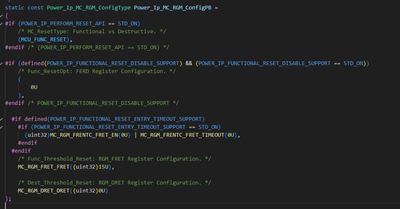

The arguments of Power_Ip_Init are as follows:
Please guide me.
