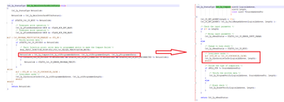

Problem 1: In the SDK C40 configuration C40_PROGRAM_VERIFICATION_ENABLED function is effective, write flash will never fail, report STATUS_C40_IP_ERROR_PROGRAM_VERIFY error
Reason: In the C40_Ip_MainInterfaceWriteStatus function, the cache is synchronized only when C40_PROGRAM_VERIFICATION_ENABLED is invalid, and the cache is not synchronized when it is valid, resulting in Verify error

Hi zhaokang,
When you enable below parameters:
you have cache synchronized before data verified:
