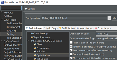

The solution you provided is ok, but there are still the following doubts(Personal understanding, if wrong please correct
① As shown in the figure, with "MCL_START_SEC_VAR_CLEARED_UNSPECIFIED_NO_CACHEABLE", the structure variables should be stored in the nocache area, but they are not.

     The user should deassert compile option "Data sections(-fdata-sections)" in project properties for making macro MCL_START_SEC_VAR_CLEARED_UNSPECIFIED_NO_CACHEABLE valid.
      If the user needs place functions to specific section, the option compile option "Function sections(-ffunction-sections)" will be also should be deassert.
      If the user deassert these options, the rough method which shown above(__attribute__((section(".mcal_bss_no_cacheable"))) is not necessary anymore.
