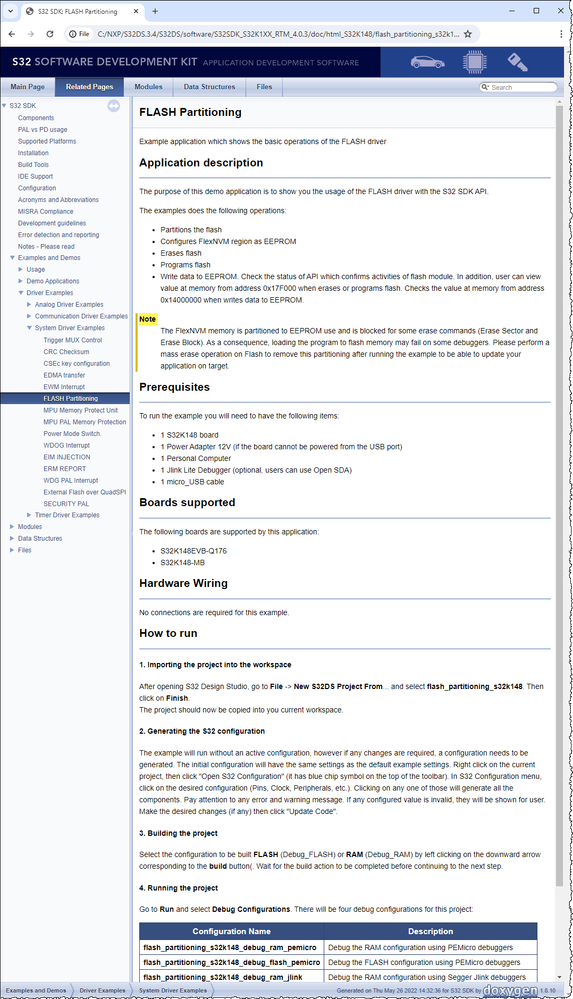

Hi Nathan,
Did you follow the project guideline? Especially what that Note mentioned.
It is recommended to install S32K1 SDK RTM 4.0.3 with S32DS Extensions and Updates in S32DS v3.4.
Or install S32K1 RTD 2.0.x with S32DS Extensions and Updates in S32DS v3.5.
Do not use S32K1 SDK 4.0.1 with S32DS v3.5. According to the currently available information, we don’t have any plan to integrate S32SDK S32K1XX 4.0.3 into S32DS 3.5 or above version.

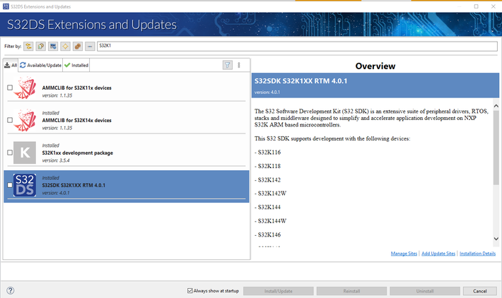

Thanks for the reply. I was not aware of those HTML pages buried in the installation. That is very helpful. Unfortunately, I'm not sure it entirely answers my question/issue.
As a consequence, loading the program to flash memory may fail on some debuggers.
I am not trying to load my program to flash. I am running the Debug_RAM. So I should be running the program directly out of RAM. With that said, could you point me to instructions for performing the mass erase operation? I don't see it in the instructions anywhere and can't immediately find it in S32DS menus.
Regarding the versions of S32DS, RTM, and RTD... I'm actually fairly confused now. I understand your bullet points of what is supported where, but when I launched S32DS 3.5, the RTD 2.0.x is not listed as an installable extension, but the RTM 4.0.x is.
So, I have a few follow-up questions:
1. What is the difference between S32DS 3.4 and 3.5
2. Why is the RTM 4.0.x not supported in 3.5? Is the RTM itself being deprecated?
3. How do I properly install the RTD 2.0.x since it is not listed in the Extensions and Updates in my S32DS 3.5?

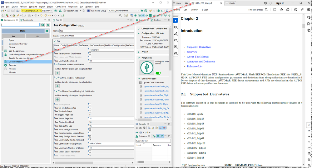

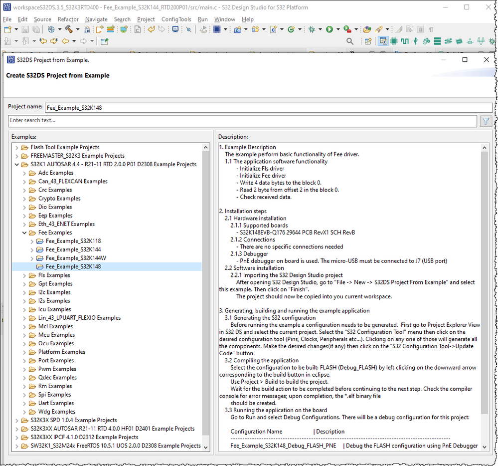

Please import Fee_Example_S32K148 project and read RTD_FEE_UM.pdf
Sorry for confusing you. S32DS v3.5 is the latest version of the IDE but unfortunately S32K1 SDK RTM 4.0.1 should not have appeared here. It should have appeared in S32DS v3.3 (already reported this issue to the S32DS team before). Starting from S32DS v3.5, S32K1 RTD replaces the previous SDK.

Thank you for pointing me to that Fee Example, but I am not looking for AUTOSAR drivers here. So I think I have the wrong driver package. But I can't seem to find a non-AUTOSAR install. Is this the only driver configuration NXP is offering now?
629 Views
Robin_Shen
Please import Ftfc_Eep_Ip_Example_S32K148 project, this is non-AUTOSAR example.
