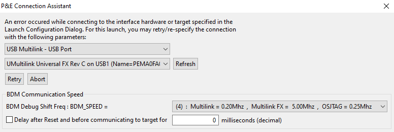

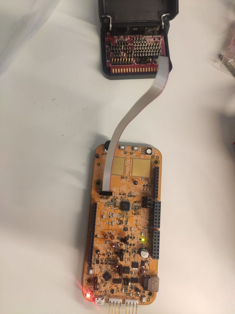

I'm trying to flash and debug an Hello World example by using the PE Multilink FX debugger with SWD connection on a S32K116 EVB.
From the debugger configuration I'm able to recognize the Multilink device, but with the default configuration an error is retrieved (see the following picture). The only modification with respect to the default one is I've checked the "Provide power to the target" checkbox.
I've noticed that the RESET red led is always turned on, and checking with a tester the logic value on the line is LOW.
Does someone has some hint on what's going on?

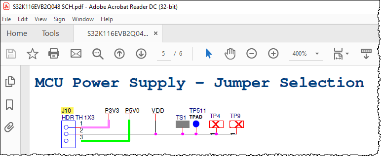

Seems that you are using S32K116EVB2Q048 instead of S32K116EVB-Q048. How is the jumper selection? J10 and J104 and J107.
Please check if the voltage provide PE Multilink FX same as the selection of J10.(You don't need to provide the power, just use the on board 5V is ok. connect 2-3 J10)
J10 MCU Power Supply - Jumper Selection S32K116EVB2Q048.pngJ10 MCU Power Supply - Jumper Selection S32K116EVB2Q048.png
Since you have external PE Multilink FX, you don't need to power the OpenSDA by J7. And you can connect 1-2 of J104, route the reset signal(SW5) direct to the MCU.

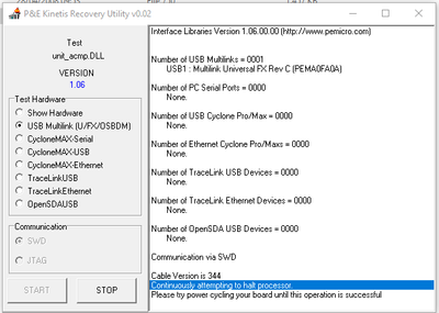

Please try to use P&E Recovery Utility halt MCU. refer:Can't use PEmicro debugger with S32K118EVB2-Q048

When trying to use the Kinetis Recovery Utility v0.02 this is the output:
If I power on the EVB by connecting the micro-USB, the processor is succesfully halted.
Moreover, the debugging through the Multilink FX is totally working when the power supply is provided by the micro-USB (no power supply by Multilink FX).

there is a misunderstanding. I'm able to debug by using the Multilink FX only when also the micro-USB cable is connected and I provide power supply to the EVB through it.
If I attach the EVB only to the Multilink FX and I try to debug the error still persist. In the previously attached photo you can see the red led showing the EVB is in reset state.

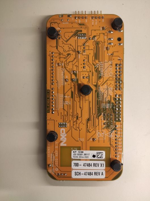

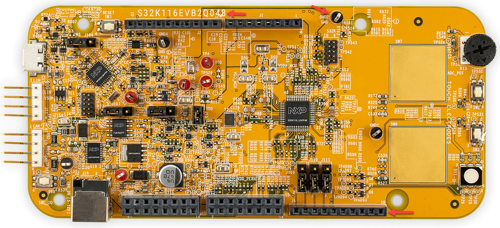

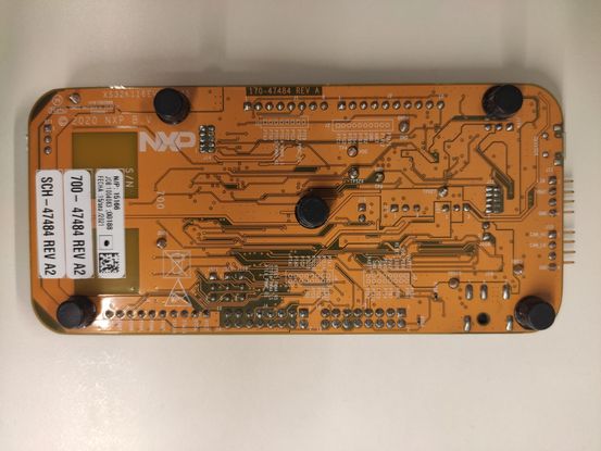

Your S32K116EVB2Q048 looks obviously different from the photo of the development board on the website. Can you take a photo of the bottom of the development board? It is possible that our discussions are based on mismatched schematics.
4,603 Views
NicoloStrozzi
Hi Robin,
here attached the photos of the bottom of our 3 EVBs.
