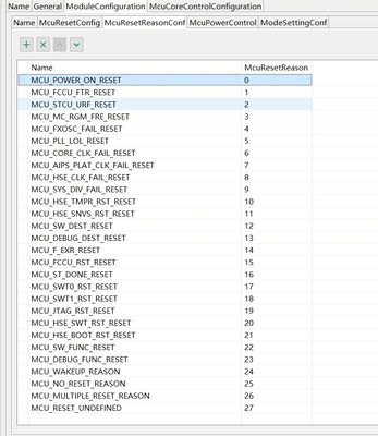

Hi @danielmartynek
Thank you for your answer.
I noticed that in the Power configuration of DS, there are some values in the picture below. Calling the Power_Ip_GetResetReason() interface returns these values, right?
Simon
2,025 Views
danielmartynek
Yes, there is this enumeration (Power_Ip_Specific.h)
BR, Daniel
