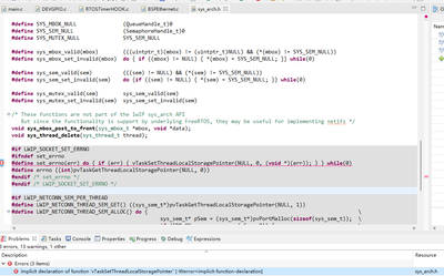

I am using the IDE's own tcpip_stack, after loading the components and configuring the relevant Settings, the compiler appeared the problem, trying to find the cause, and finally did not solve, want to ask NXP engineers, the problem is not because a setting is not paired, resulting in errors, please help to point out, thank you ~

The compiled project is my own creation, RTD, S32DS, tcpip_Stack version see the picture above.

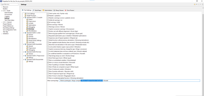

Yes, I am creating a tcpip project based on S32K314; Since the company's computer has encryption software, I can't share my project for you to review, but I can share the screenshot to you, see the picture above, I only added these components, after the configuration, the initial compilation alarm appeared, but I repeatedly consulted the contents of the components, and never found the configuration that can eliminate the alarm.

Got it. So can you show me the declaration of function vTaskSetThreadLocalStoragePointer?
Is that one of driver's stub functions?

shunyizhang
Is that it?

Also, please help me to try:
- Increase this param higher than 0.
- Remove Warning flag mentioned in compiler errors.

shunyizhang
I've solved the problem. This place can't be zero.
