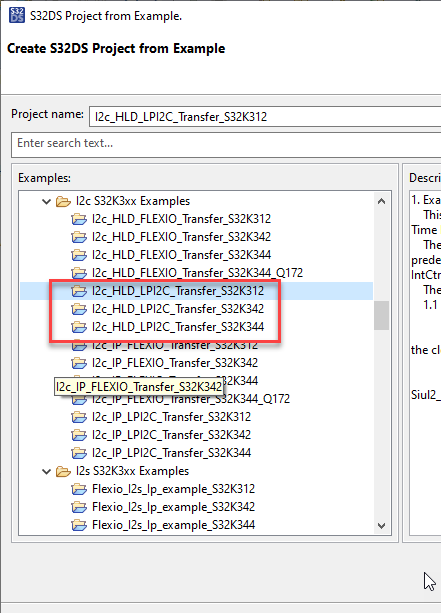

 Additionally in all the examples for I2C which I have found is used FlexIO.
So do I understand correctly that if I want to use I2C RTD driver (HLD or LLD), so I always have to use FlexIO as well? If yes, so what is the reason for that? Why LPI2C_0 /LPI2C_1 peripheral is not enough for I2C RTD?

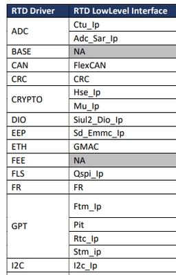

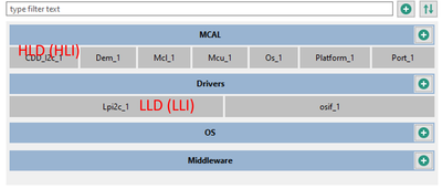

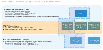

As I understand so I2C driver is implemented as CDD and provides API for HLD (HLI) and LLD (LLI). As I understand in picture below under "MCAL" tab are written HLD drivers and under "Drivers" tab are written LLD drivers. Is it right? Why CDD is used in MCAL tab only ? LLD is implemented in CDD as well, right?
Why there is not used "IP" in upper picture in tab "Drivers" for I2C LLD driver?
In picture below is "_IP" used for LLI (LLD).
Real-Time Drivers (RTD) for S32G Product Brief (nxp.com)
Thank you for any hints

1) No, marked sentence clearly says LPI2C module can be used. It is possible example does not exist for all options or derivatives. Or it does not exist in certain RTD release. For instance I can see it with my installation:

4) Yes, you are right. I am not sure why it is marked this way in S32DS, to be honest. Apparently just is based on AUTOSAR, so it uses its terminology.
