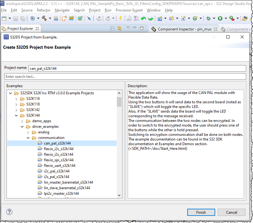

I have nxps32k144evb and I am writing program which include 4 functions. My program has to generate digital signal about 1000hz frequency (square signal) - I did it. Secondly reading this signal using FTM - I did it. And now I Have to send signal value (Hz) in fixed time interval (1 second) using the frame by CAN interface. Could you help me how can I do it? Do you have any similar program or code which do this function? How can I implement this function?
936 Views
Robin_Shen
Hi Mike
There is a can_pal_s32k144 example in S32SDK that you can refer.
If you are interested in CAN examples, you can also refer to this article: S32K1xx SDK FlexCAN sample projects to demonstrate its basic and advanced features
